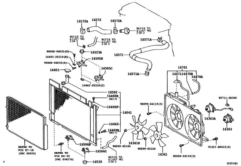

    A lot of online Toyota part sites only show this:
    I found this:
    Here are the part numbers.
    The 8 bolts that hold the individual rad mounts to the radiator itself: 90068-04035
    Replacements are M5-0.8, 10mm length (I ordered mine from a hardware store in stainless).
    The 4 bolts that hold the fans to the mounts: 91621-B0616
    Replacements are M6-1.0, you will want 20 or 22mm length.
    Then the screws that hold the condenser to the radiator: 90068-04036
    I would suggest using a bolt rather than the original Phillips screw that strips easily.
    It's M5-0.8, I would suggest a 22mm length, or if only a 25 is available, using a couple washers, you don't want the bolt extending past the nut welded on the mount.
    The rubber insulators for the top side of the radiator 16523-23010
    For the bottom mounts: 90480-40016
    The mounts themselves, upper: 16505-21010
    Lower: 16506-21020

    There seems to be two parts store versions, one for the consumer that doesn't show as many parts, and ones for techs that do.
