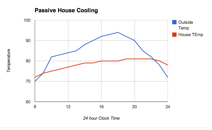

    I am fortunate to live in a dry, high desert climate that lends itself to cooling the home at night with ventilation by wind and fan. I have spent a lot of time trying to optimize night time cooling while decreasing heat gain during the day. It is an ongoing effort. I still leave windows partially open during the day for air quality, although only on the side of the house opposite wind direction as a klunky way to have adequate air exchange during the day but no more than needed since the outside air is hot.
    June has been hotter than usual during the day, but nights reach nadirs of low 60s F. To my annoyment, the wind picks up in late afternoon and pretty much dies at night. The house has reached a pattern of sorts for now, that is plotted below:
    The in-house temperature rise duing the day interests me the most. Even though the temperature gradient between in-house and outside rises as the day wears on, the temperature increase rate is greatest in the AM hours. I think two factors are at play:
    First, the house temp as opposed to the in-home air temperature is likely hotter, and my first few hours of the day are an equilibrium asserting itself. The thermostat may measure 71, but the house is actually 2-3 degrees hotter. Median outside temperature is about the same as median in-house air. I really think I should be able to improve the median in-house air temp to at least 3 degrees lower although I'll declare success at 5 degrees. After all, I supplement cooling at night with fans and tinker with the windows!
    Second, most of the sunshine that enters the house is during the hours from 7 - noon. I have no idea how to convert the heat entering as sunshine into temperature since it depends on the heat capacity of the house, but every bit matters and the areas where I still have too much sunlight are in queue to be blocked.
    Advice and anecdotal experience welcome!

    Have you succeeded in dropping the houses air median temperature below outside ambient ? An average of (low+high)/2 is a pretty good appoximation.
    I have tried closing doors and windows during the day but the house gets stuffy and humid quickly. I find I prefer warmer with some airflow and more pleasant air quality. Do you have a trick I am missing ?

    What is humidity level? If the place is very dry (desert), then 80° F can be very comfortable.
    A heavy brick, concrete or other type of wall can accumulate a lot of energy and heat from one side of the wall to come to the other side can take up to 12 hours. The walls cool from both sides during the night and heats considerably more from the outside during a day. Heat from the inside (cooking, fresh air ...) is also not that small factor.
    The night is probably too short to cool the walls completely to the outside temperature, so the moment you close the house the temperature will go up faster than you would think and will reach or go above the wall temp.
    Buy a cheap IR temperature meter and measure temperature of the walls from the inside, you may find a spot that heats up faster than others, maybe you can improve that spot.
    What is the structure of the wall? When you write "passive home" in my area means a house with 30 cm of light insulation and verry thin walls, those houses don't do very good in hot climate, but they need little to no energy in the winter freezing temps.
