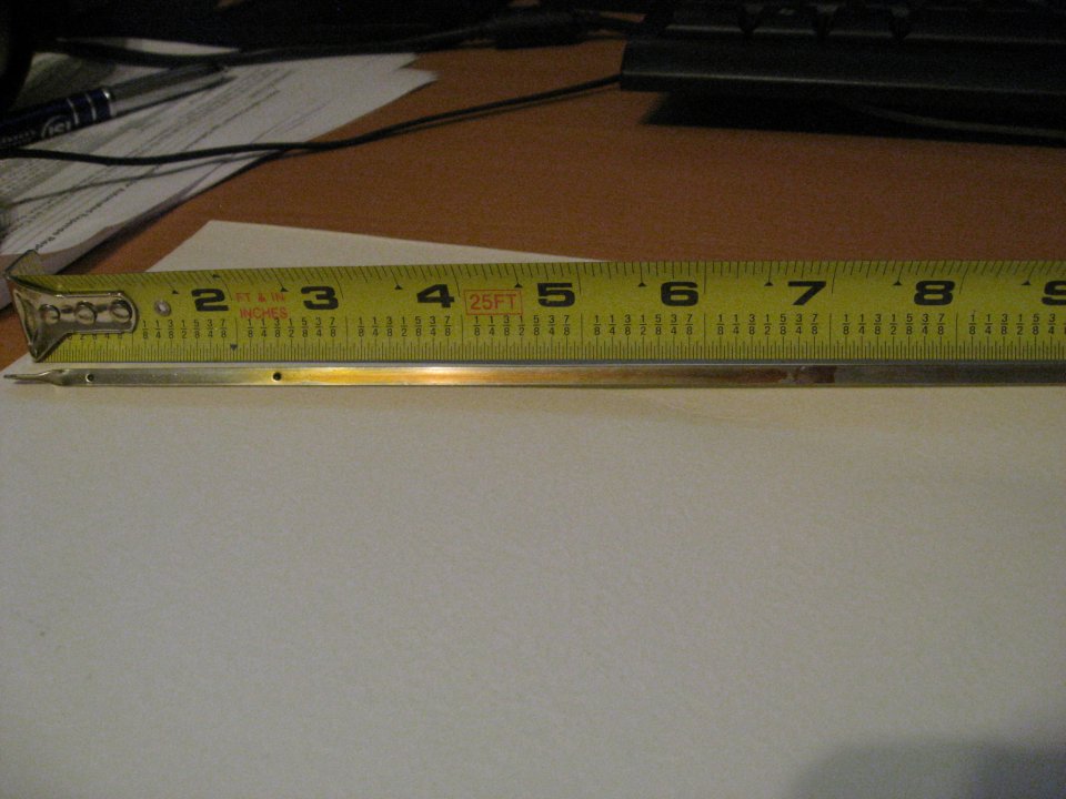

    it will not go away after wiping; not sure what to call it (from 2" to 7")
    should i be concerned or this is normal for 150k?
    April 2014: oil changed @ home with Pennoil 5w30 3k interval (only ~3 quarts comes out)
    Jan 2014: oil changed @ Toyota Dealership 5w20
    Oct 2013: oil changed @ home Pennoil 5w30 , OEM ATF changed
    i also have 2005 prius with 196k mileage and the dipstick is shinny all the way. so this is abnormal.

    I would not say that the stain on the dipstick is "normal" but as long as the engine is running OK and there are no unusual noises or warning lights on, why worry?

    Thats pretty normal for a car that spent it's life on dino oil usually crappo dealer vat oil. Lots of crankcase vapor. You'd be horrified if you pulled the valve cover.
    If you want to really see some crap look in the throttle body.

    That stuff will wipe away if you use acetone to clean it. soak it for a minute and wipe with a strong paper towel. You have to repeat it a few times but it will wipe away.

    Yep, its varnish. It's also all over inside the engine. It's from running too long with too low oil.

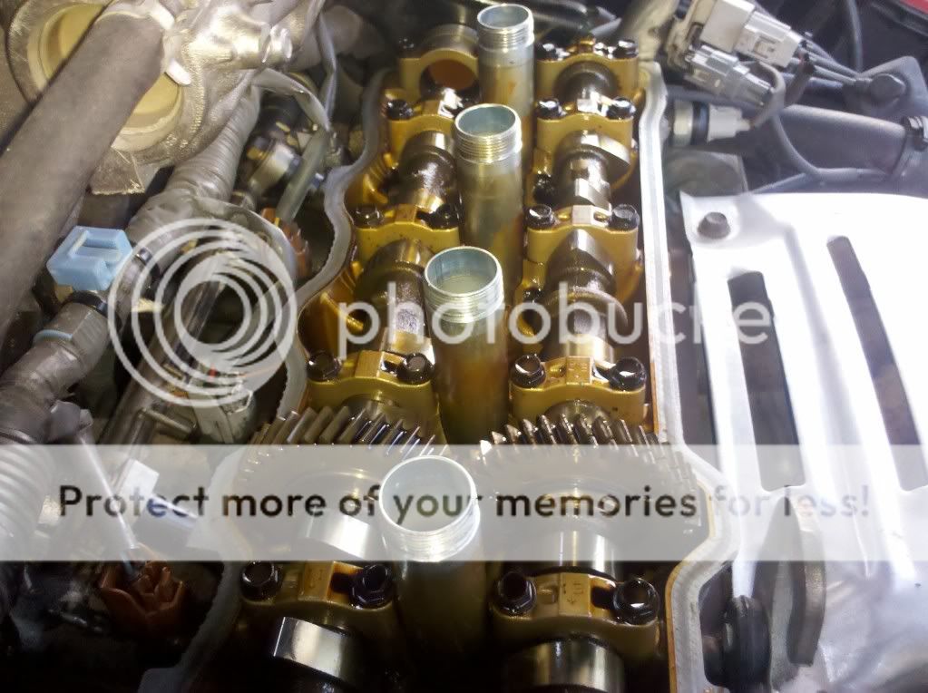

    Here's a pic of varnish on cams and such under a valve cover.
    There are volatile components in oil that evaporate in use. These volatiles condense on cooler surfaces, and the color is tan/brown. This can be mitigated by using an oil with a low-volatility value (NOACK), changing oil sooner rather than later, or using an oil known for its cleansing properties (and/or synthetic oil.)
    I've used a product called Auto-RX that did a job on cleaning this off. It worked great on one vehicle but not so great on another. I believe the difference was the oil splash pattern under the valve cover was excellen on one vehicle and lame on the other.

    Mr. Incredible's picture of the valves is interesting, since it looks like some components are heavily coated and others lightly or even not at all even though the metal is the same.

    In my experience, varnish forms on parts that are splashed by oil, but not constantly immersed. Examples would be a valve cover or that upper part of dipstick as in the OP picture. It makes sense considering that varnish is caused by oxidation of long oil chains and if a part is not immersed in oil, it's exposed to blow-by gases.
    Now, if one runs low oil level, oil and many engine parts will be hotter, speeding the varnish formation. I had a dipstick varnish, just like the OP, in my corolla when it started to drink oil and level dropped to lowish at the end of OCI. I cleaned that and there was no dipstick varnish anymore when I kept oil level at the high mark.
    This is why the advice given on the priuschat to keep oil purposely low or use radiator blocking (to boost MPG) is wrong. That results in too hot oil, internal varnish, and oil coking in piston rings resulting in oil consumption later on.
