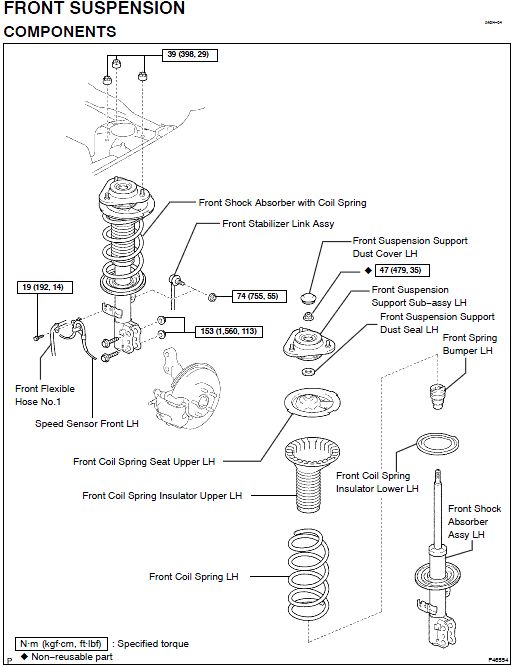

  17. Dylan Doxey
    Dylan Doxey Senior Member
    Mar 15, 2013
    1,389
    3,458
    92
    San Diego, CA
    I read somewhere that this type of clunking can occur when the lower insulator ("Coil Spring Insulator Lower" in the diagram below) is not installed correctly with the new springs. I would start with checking if the spring is sitting on bare metal or if maybe the insulator is bound up or damaged.
