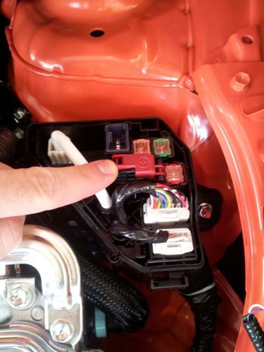

    In the later 2013s, it is here:
    Looks like it was a mid year change, c's after 1/13 have it

    We still have a hot wire in that location, we just don't have the jumper plug.

    in the fuse box. you should have a heavy gauge positive wire coming there. if you have a 2013 that was made in 2012 you wont have the jumper connection.

    Look in the picture above and compare to your car. It will be in the exact same spot, just will be a bolt instead of the terminal.
