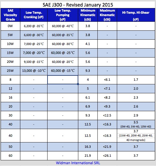

    I hope you meant SAE 30 weight oil, not SAE 30W. ;)
    It appears there is officially no 30W standard.
    from SAE J300 | Widman International SRL
