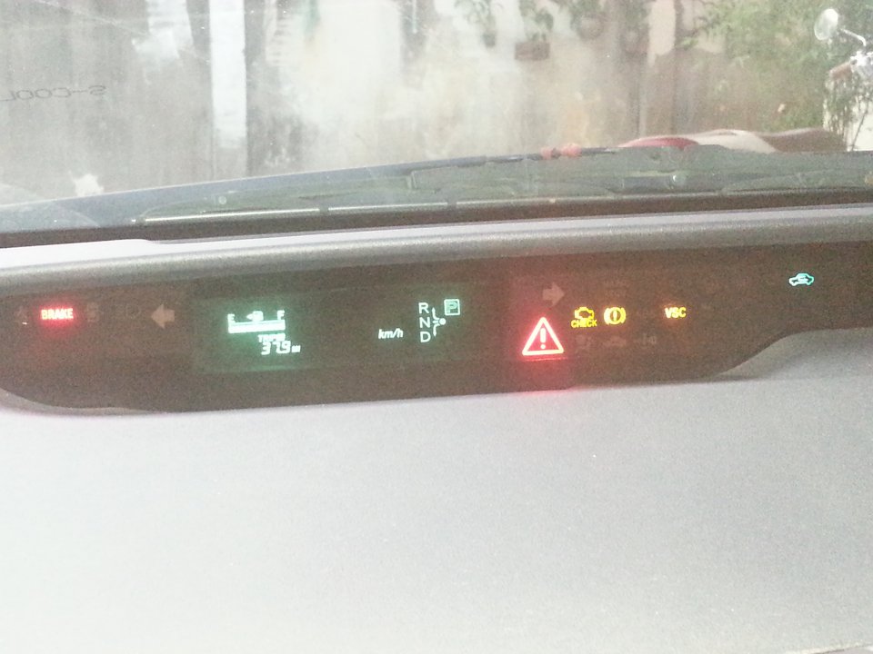

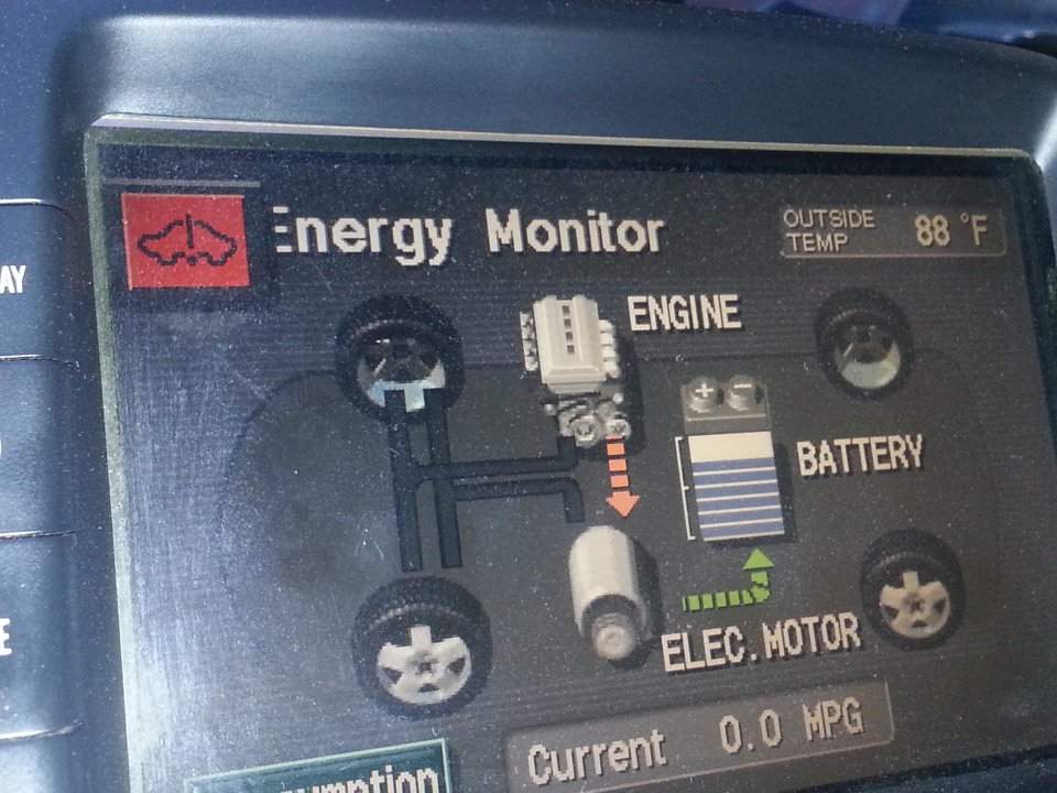

    My Prius 2004 with mile: 14x,xxx get problem with master light and another 3lights follow photos in attachment.
    After i brought to dealer to diagnostic check and found error code U0293 (lost communication with control system).
    Note: I can drive it and everything work fine, if i restart the car few time than the Master warning light is off and appear only CHECK light and Master warning. If i try to restart the car another few times then all the warning light went off as normal.
    Dealer cannot found problem, can anyone HELP please! :(
