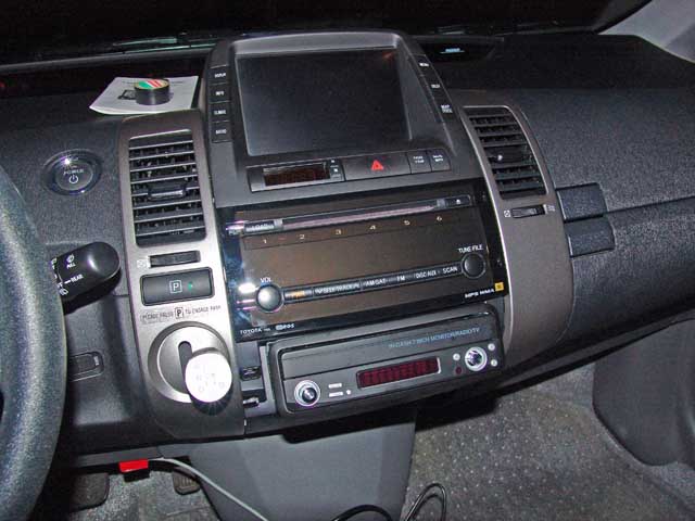

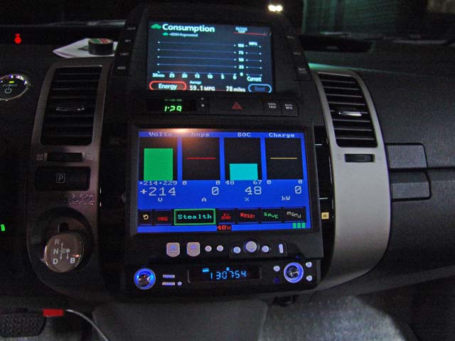

    I can now verify that the in dash Lilliput screen GL701-NPCT works with the Can-View V4!
    You can get one here for $397
    http://www.geeks.com/details.asp?invtid=GL...PCT&cpc=SCH
    I'm currently installing it in my car. I will report back with pictures hopefully tonight. :D

    OK after slicing my thumb and nearly taking off my finger with a dremel I finally got the screen installed. I cant do any project with out drawing at least a little blood. The more blood I draw the better the finished project. <_<
    This was not an easy out of the box install. There is a lot of work to do to get the screen to fit and work. I did not take pics of the install process since I was running out of time and I had to wing it on most of the install. I will try to describe everything I did to get it working.
    You have to take the radio out of the car to install this screen.
    You will also have to take the bottom face plate off of the Lilliput screen.
    You will have to take the door off the map slot.
    You will have to remove the map box thing you keep your crap in so you and put in its place the Lilliput screen.
    The screen is too wide and too tall to fit through the plastic face of the map box so you will have to make a few cuts.
    I had to cut the bottom of the map box plastic face. This was easy as I use a dremel to cut along the little angel that is on the bottom of the opening. This is about the perfect size for the screen to fit. If you cut along that angle you may have to file it down just a little bit for the screen to fit.
    I also had to file down the sides of the plastic map box face plate so the width of the screen would fit through. Its mostly trial and error.
    To keep the screen from moving around I made a bracket that connects to the 2 small screws that are in the top back of the Lilliput screen. Each bracket is connected to the extra hole in the metal bracket of the radio unit using a bolt and nut. This hole is right beside the one I took the bolt out of to get the radio out. This will keep the screen from sliding in and out. There might have been a better way to do this but I did not have the time or the supplies to fool with it.
    Now that the screen is mounted to the radio bracket I had to do one more thing. The holes that I used for the bolts to keep the screen from moving in and out are used by the car. The car has little nipples ( :lol: had to say that ) that help guide the bracket back in. I had to use the dremel to cut off that nipples and drill them out to make room for the bolt heads. This will allow the radio bracket to rest flat like it should. If I didnt drill them out the bolt heads would prevent the radio from snapping back into place.
    After getting the cables the way I wanted and hooked up correctly I installed radio. I then attached the map box face plate. This was a very tight fit. I then installed the Lilliput face plate. Then I installed the rest of the car parts.
    The Lilliput screen sides are bare metal. To hide the metal a little I covered the top and sides with black electrical tape.
    I will try to correct anything tomorrow if I messed up this post. I will also answer any questions tomorrow. In the mean time here are a few pics. I will try to make a video tomorrow when there is more light.

    Wow, quite a project, definately not a simple 'plug and play'...but it looks pretty good and should work great. I'd love having the regular MFD seperate from the CAN-View, but I ain't buying another one and going to all that trouble!
    But good for you.

    Hate to brake it to you but I dont think I will ever install one of these again. This was a huge PITA to get everything right. On a scale of 1-10, 1 being that anyone can do it and 10 being leave it to a pro I give it a 9. Very hard install ( at least for me ) but I think the next time I want something like that installed I will just take it to a pro.
    I would however help out a little if your were to ever come this way or if I'm ever down that way. :D
    So far everything seems to be working great. I now have so much information to look at I'm watching the can-view more than the road. ;)
    All I have to do now is find out what info I want displayed on the screens.
