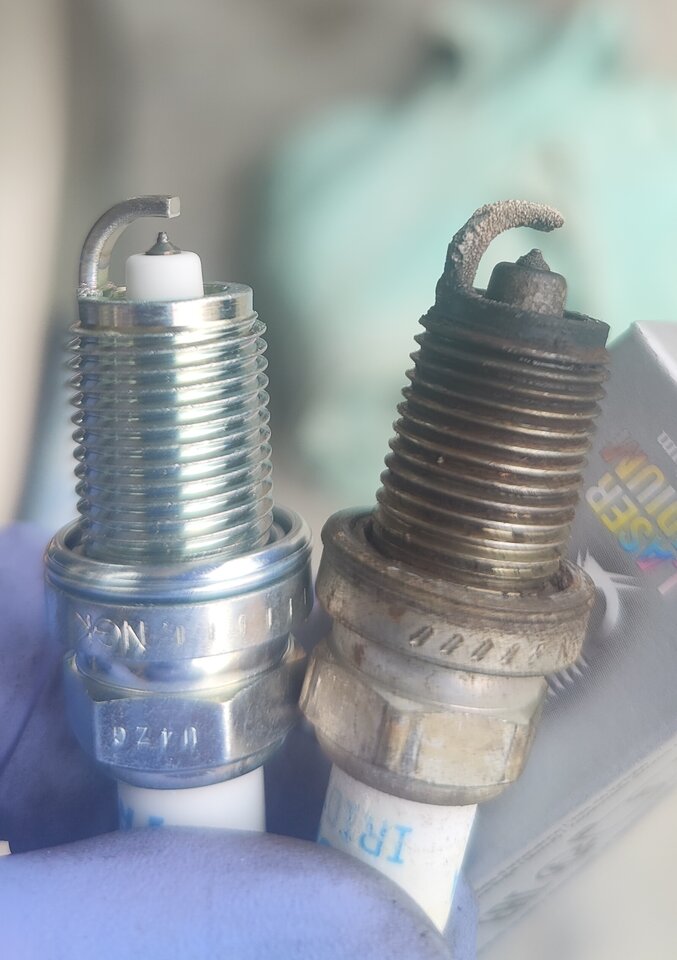

    I have an issue that seems to be getting worse and has gotten annoyingly worse after new plugs and throttle body clean.
    Has always seemed to ping a little under load when at operating temp and slight/moderate acceleration. Didn't think much due to many other cars doing the same.
    Then started to rattle on cold start, stumble/shake.
    Recently changed plugs and cleaned throttle body a little (in situ). Old plugs all blistered. Cleaned pcv valve. Seemed to move ok?
    Engine start shake seems a little harder, and it's revving high when coasting down or low speed idle, slowly coming down at complete stop.

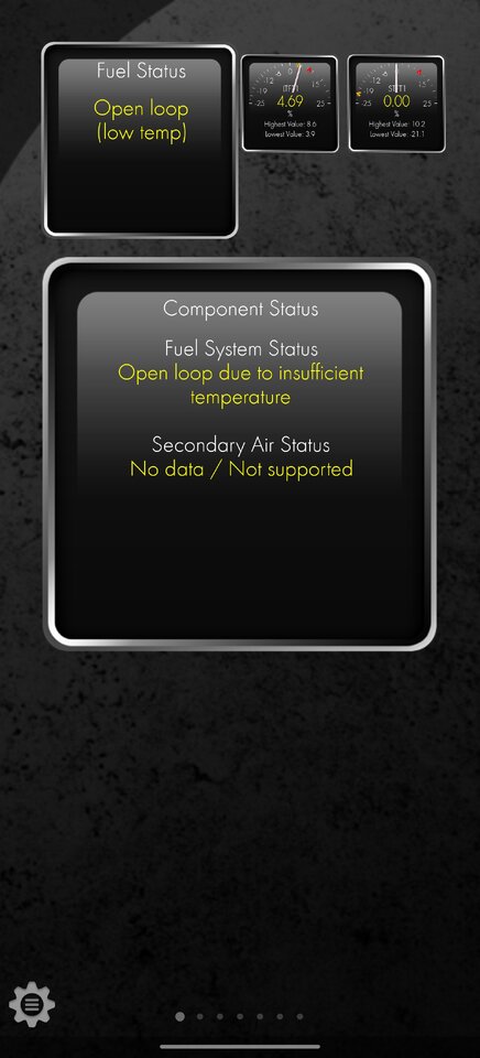

    I did a battery D/C.
    No codes from my OBD2 Bluetooth. It's old but has shown a misfire before when there was a tiny bit of moisture in one cylinder.
    Any thoughts or other things to check? I guess I could clean the maf though it didn't seem very dirty looking at the temp "football" thing in there

    oem plugs from a dealer?
  3. Rennie
    Rennie Junior Member
    Jul 11, 2016
    23
    Australia
    NGK Iridium Spark Plug - IFR5T11 from local auto parts shop
