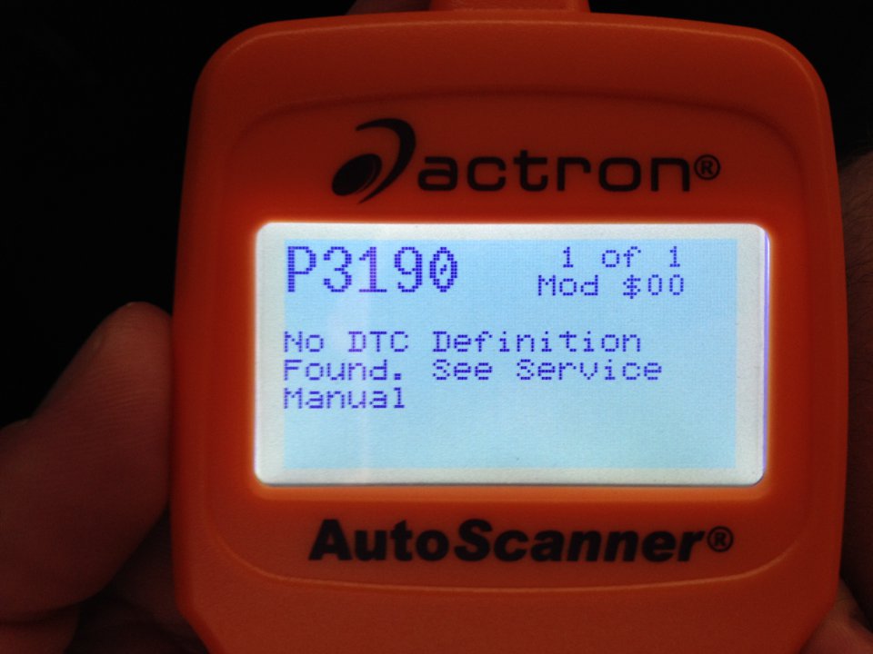

    Well, I figured I would follow up with the status of my issue. I believe you all were right and it was a simple as a prematurely empty tank.
    Tonight I checked the CEL with my scanner and it read code P3109. My scanner didn't have a definition for that, so I did some research and from what I can tell it's morIe or less a generic code indicating that the car lost power.
    After turning the car on both the triangle/exclamation mark and CEL remained on while I drove it for a couple of miles. When I got home I turned it off for a moment and then back on. This time only the CEL remained. I cleared that with my scanner and took it for another drive. After getting home I turned it off & on again, and the dash stayed clear. Seems to be working fine now, but I won't be completely at ease until it gets a few more miles on it.

  11. Patrick Wong

    I don't think P3109 is a valid 2G Prius DTC, but P3190 means low engine power, and one reason would be an out of fuel situation.

  12. Beau08
    Beau08 Only know enough about it to drive it...
    Feb 24, 2010
    Indianapolis, IN, area
    Yep, sorry, I screwed that up...
