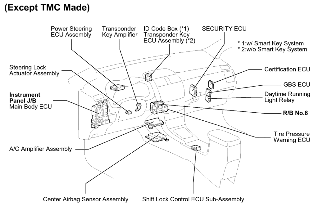

    Looking to install a remote start on my 2013 prius 2 does anyone know the location of the ECU electronic control module thank you Gary

    I believe it is behind the panel with the switches (like the mirror switch) which is to the lower left of the steering wheel. There is a screw in the bottom of that panel that is behind the door sill panel. Look at the instructions for installing the aftermarket fog light kit.
