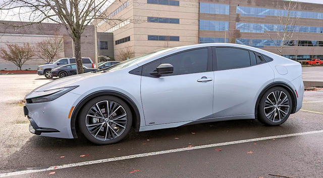

    I just installed these springs on my car. Overall it was a pretty straightforward job if you've done springs before. The only part that was different than most was that in order to get to the strut top nuts you have to remove the wipers and all of the plastic trim below the windshield which took me a little bit of time to figure out.
    Super happy with the result. The AWD springs are supposed to do 20-25mm drop in the front, and 40-45mm in the rear. The fender gap is about 1 finger on the front and two in the rear now, not too low for a daily driver. I think it feels a tiny bit more firm and supported than stock but nothing I would consider harsh.
    I was going to do the rear sway bar as well but the Cusco rear bar I received wouldn't work. It was straight where the stock bar has bend in it to go around the motor system. I sent it back for the front one instead, still waiting for that..
    Pics later, it's absolutely atrocious outside at the moment.

    Caught a break in the rain long enough to snap a picture. (y)

    Picture broke, reuploading..

    So you didn’t have to get the camber adjusted after installing the springs?

    Looks great! I ordered a few suspension items from TMR and will have them installed in a few weeks. Looking forward to the new look and feel.

    Looks good! What is next on the list?

    Car looks great. What is the exact tint specs if you don’t mind? Same tint on front and rear doors? Taking mine in asap and yours looks great.
