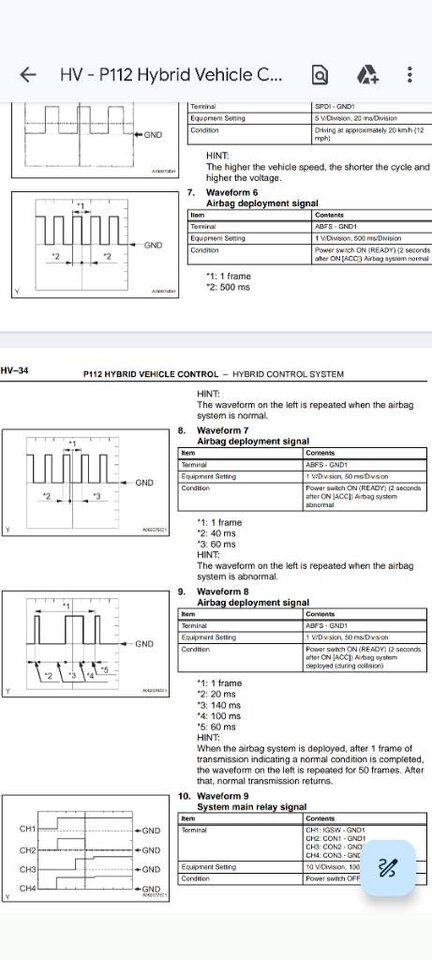

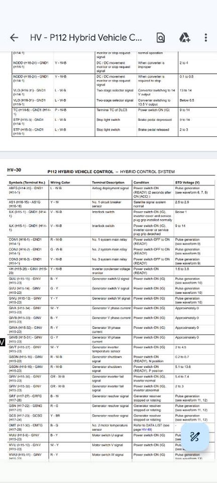

    Now that all airbag systems are unplugged up to the control unit at the base of the center console I am left with warning lights....
    Questions;
    1. The cruise control module receives an airbag status signal. If that signal is NO.. The cruise will not set.
    To enable the cruise control... what signal is the cruise module waiting on and how can I fake it..
    Qualifiers. If your thought are WHY?. PLEASE Ignore my post and save the bandwidth for those who have a deeper understanding on how the ECUs interact.
    a. it could be a simple on or off signal.. of various voltage.. It could be a could be a can-bus signal.

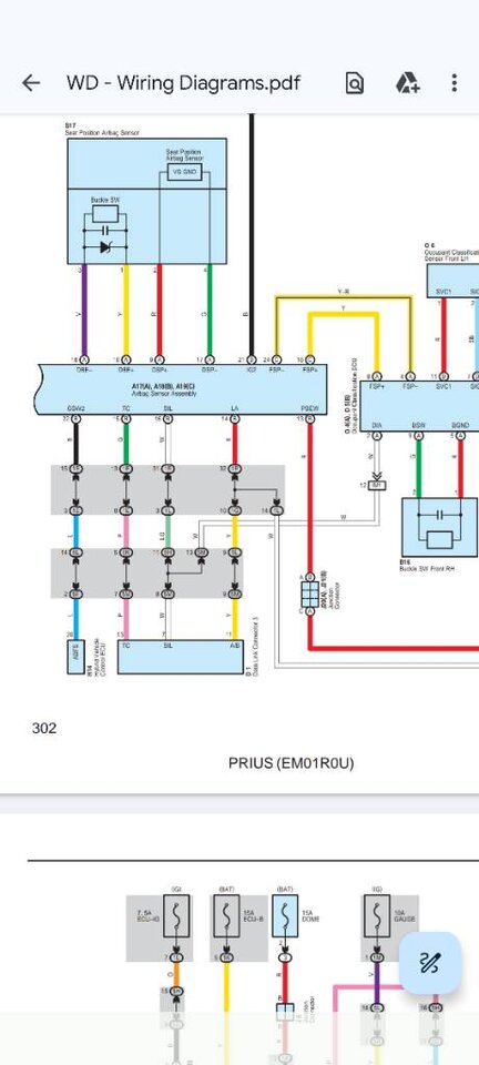

    b. does anyone have a diagram of how the Air bag module talks to the Cruise module and what the communication is to work?
    2. Other question to follow.. this is the current pressing issue.

    There's an online service manual available that may have some information. Maybe the SRS and CC sections? It may take a bit of sleuth work, but hopefully you can find what signal is needed to simulate "normal condition".
    Service Manuals - Google Drive
