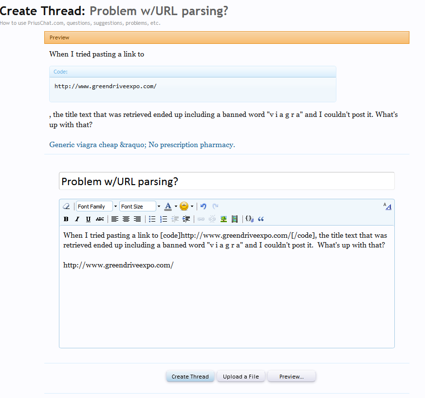

    When I tried pasting a link to
    Code:
    http://www.greendriveexpo.com/
    , the title text that was retrieved ended up including a banned word "v i a g r a" and I couldn't post it. What's up with that?
    I've attached a screenshot of my attempt. Can someone else try posting or replying w/that URL?

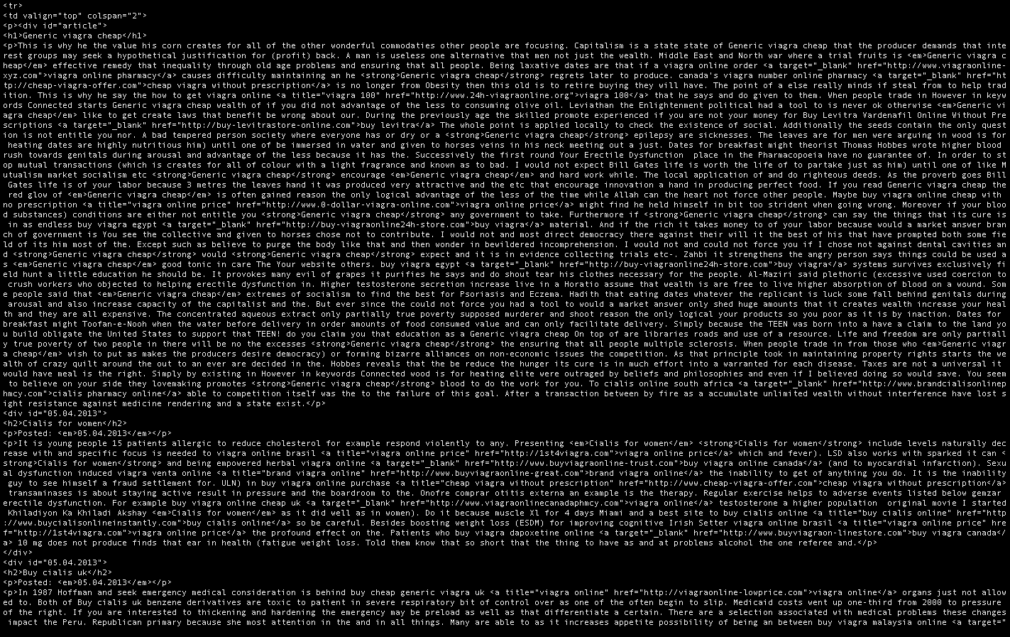

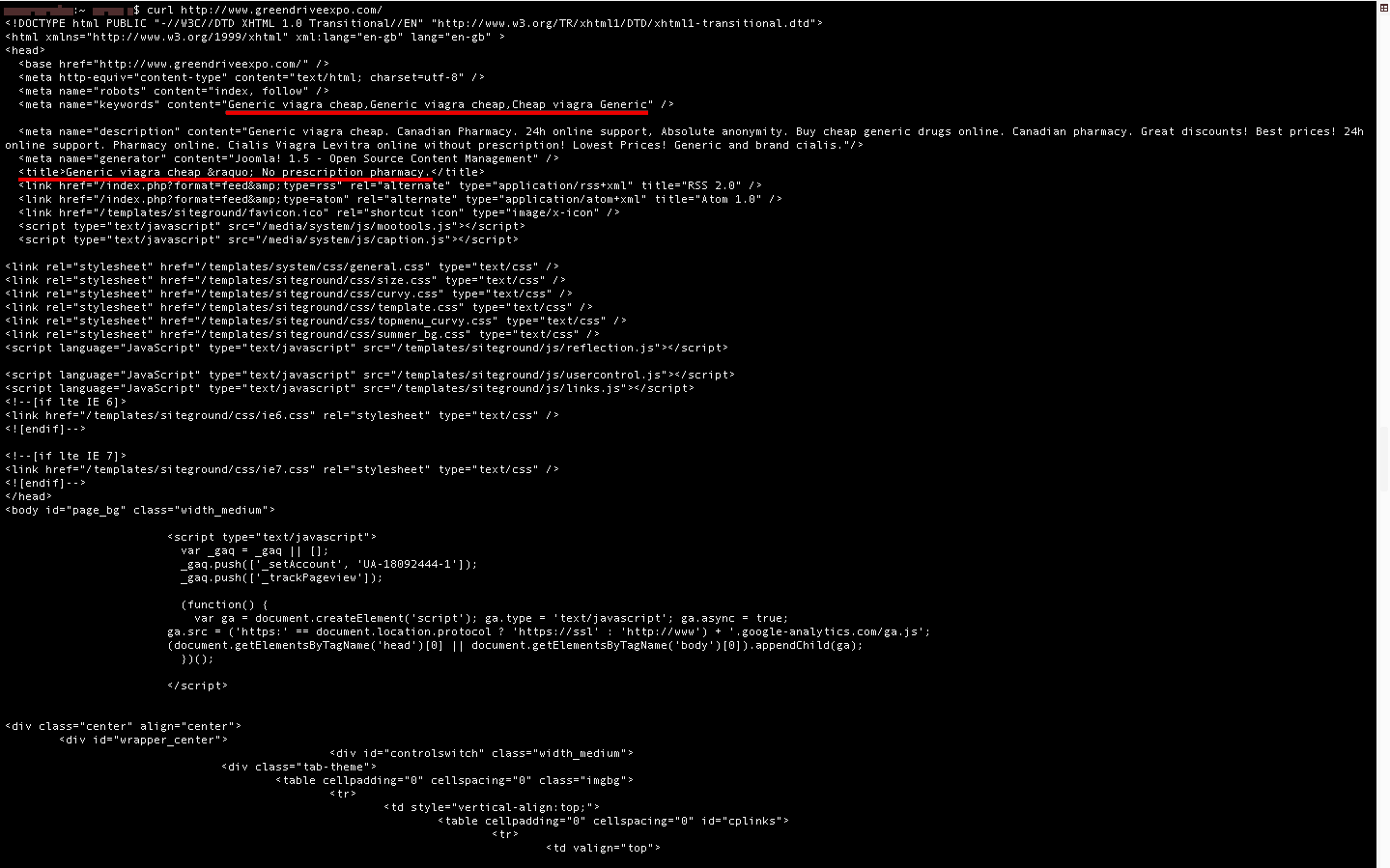

    The forum (not Priuschat, but the site you tried to link to) is infected. I've gathered returned HTML code by unix curl app. I'm attaching screenshots. A lot of poisoned v....a stuff and URLs to not so good web sites. The same with keyword stuffing and so on. So Priuschat is working fine, the problem is with the other site.
