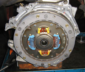

  11. RobH
    RobH Senior Member
    Sep 18, 2006
    2,369
    984
    70
    Sunnyvale, California
    It looks like a clutch, it can slip like a clutch, but there is nothing there to engage or disengage it. I think it is just a safety device to prevent damage to the transmission if the engine backfires. Maybe it could be called a torque limiter.
  12. a priori
    a priori Canonus Curiosus
    Aug 14, 2007
    3,083
    407
    23
    Chicagoland (West)
    Warning: I am not an automobile mechanic or an expert on planetary gears. I'll agree that it looks a lot like a clutch plate in an assembly, but I believe you are wrong to say it disengages the ICE from the PSD. In fact, the ICE is integral to the PSD because there is no mechanism to separate the ICE crank from the PSD. The difference is that the ICE doesn't connect directly to MG2, so it doesn't ever actually drive the front wheels. The ICE's output powers MG1, one way or the other, and assists MG2 in turning the chain that drives the wheels. (Whew! Sounds a bit like a conductor explaining what drives the little engine that could.)
    That sounds about right to me. I think there is no way for the pressure plate to let go and allow the clutch plate to move. It is all part of the flywheel assembly, I think, and appears to be a torque dampening device, if anything.
    (Where are those engineers who really know how this thing works?)
  13. evpv
    evpv Active Member
    Apr 19, 2010
    690
    337
    West Coast
    2019 Prius Prime
    The instructor in the video calls it a clutch a couple of times, see the 6:00 mark. Seems like a waste to have a clutch disc and flywheel if it doesn't do anything.
    Some Prius clutch discs for sale:
    Prius Clutch Disc Search
    The AC compressor has a clutch, so there is at least one clutch on a Prius. :)

  15. macman408
    macman408 Electron Guidance Counselor
    Mar 21, 2010
    1,179
    367
    According to the paper from Argonne, it's a torque-limiting clutch. RobH and a priori are correct; there's to way to disengage the clutch, it's always connected, and will only slip to protect the system.
    So, if you pay attention to any of the other parts of that video, you'll notice that it is quite possible for the ICE to run when the wheels don't move, or the ICE to be stopped while the wheels are moving, or the ICE to be spinning but not use any gas when moving at a high speed; and no clutch is used for this. Disconnecting the engine from the wheels is accomplished electronically by using the motors in combination with a fancy set of gears.
  16. V8Cobrakid
    V8Cobrakid Green Handyman
    Jun 6, 2004
    3,790
    152
    Park View, Los Angeles, CA. U.S.A
    i would call it a shock absorbing plate. clutches can actually spin. this plate never goes out of rotation from the inputs and outputs it's attached to. it will only shift back and forth so abrupt stops from the ICE and changes between regen and assist are not as intrusive to the driver. it also probably limits wear on the whole system.

  18. Priusrage
    Priusrage Junior Member
    Jan 21, 2011
    38
    Columbus
    The clutch in the Prius is a safety devise. It’s always engaged
    as told in the video above. With the ECVT transmission there is no
    need for a clutch. It’s for protection of parts only. So, there is no
    engage and disengage. It’s always engaged.
  19. Mike Dimmick
    Mike Dimmick Active Member
    Aug 8, 2008
    963
    249
    Reading, UK
    That's the Transmission Input Damper, according to the diagram on page EM-89 of the 2006 service manual. It limits the torque that the engine can deliver to the transaxle - basically it starts to slip if the torque exceeds a threshold level, but below that level, the plates are locked and the input shaft revolves at the same speed as the engine's flywheel.
    I note that you stole that image from ArtsAutomotive.com. The paragraph immediately above the image reads:
    "There is a sort of clutch-like damper assembly between the engine and transaxle, but it only provides a little damping, no actual clutch like action."
    Source: Prius 1st gen - Replacing Transaxle
    I name thee troll.
