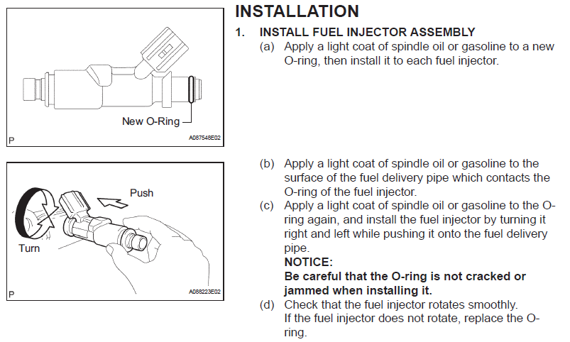

    That's been a problem for others before. Inserting O-ringed things into things isn't exactly complicated but there's a touch to it that's essential. Toyota puts pictures in the repair manual but could stand to emphasize the importance even more.
    As in that manual excerpt, what they specify for lubing the O-rings first is gasoline or maybe "spindle oil" (bit more obscure and hard to find).
    If the O-ringed end of the injector doesn't get fully seated in the fuel rail and then you crank down the fuel rail bolts, it can end up kind of squashing the injector. Even if it doesn't look bad, it could possibly bind internally or just not work right. More headaches.

    When you fit the injectors into the head and then put the rail on top of them and what have you You will know it feels correct when you can rotate the injector between the rail and the cylinder head where they're seated you should be able to rotate them around very smoothly it will feel like you're turning a damp knob on an old or older radio kind of smooth rubbery feeling If you get those o-rings cockeyed wampy jawed or anything like that this is exactly what you will have is leaks so now you need to undo the feel rail lift the mess up off of there and try it again It is remotely possible you damage and folded an o-ring doing this so look at them all carefully I use my magnifying glasses when I need to to make sure I haven't crimped or damaged any of the o-rings once you do this twice you'll immediately know what happened pretty much.

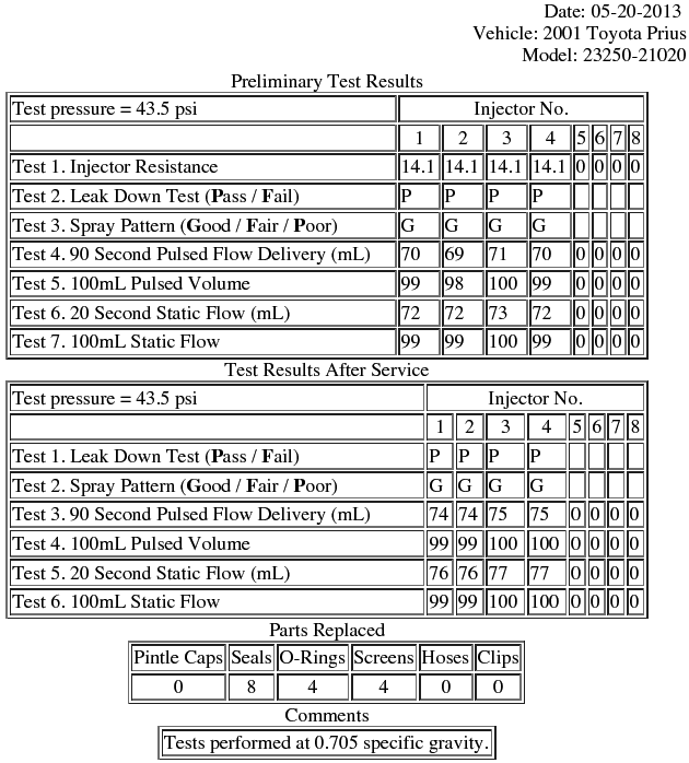

    I'd leave them be unless I had some concern with how the engine was running and wanted to know if they were the cause.
    If I did have that concern and wanted to know, I'd have them tested and restored.
    These were clearly not at fault in the car they came from:
    And these clearly were:
    Note that in the bad set, three were kind of mildly bad before restoration, but #2 was much worse. That kind of imbalance can make for very rough running.

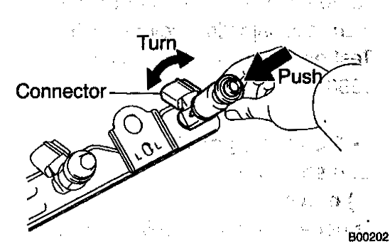

    If so, I think you'd make your life easier by following the repair-manual illustrations in #4, and twirling the injectors with their O rings into the fuel rail first, as those are the tougher connections to get right. Fitting the injectors down into the head next isn't as hard.
    It's the connections to the fuel rail that have to withstand fuel-line pressure all the time without leaking.
    Where they sit in the head, those connections just have to seal against the intake vacuum, which is less of a challenge.
