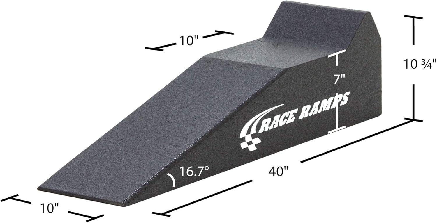

    Expensive, but these race ramps will work on grass, dirt, asphalt or concrete without damaging the surface.
    It would also be ideal for any garage with floor tile mats or epoxy finishes.

    Just use the rhino ramps That's best for the Prius low to the ground business anyway they're made out of plastic they won't scratch your $10,000 garage floor and they certainly won't hurt the driveway out in the weather now metal can be pushed across the driveway or the garage floor by the car trying to get up on the ramps that is a fair thing to happen so it'll put a white line on your driveway and will scratch your fake epoxy floor quick fast in a hurry The rhino ramps will not If anything the rhino ramps if they slid on your epoxy floor thingy they'd put a black mark that will come up with the blue Scotch-Brite pad.

    If you are going to spend $10k on a G garage floor, $200 for a set of Race Ramps is nothing much more.
