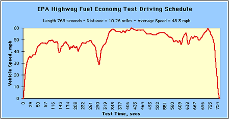

    Take a look at the EPA Highway Fuel Economy Driving Schedule [once on that page click on the link for "Appendix I to Part 600—Highway Fuel Economy Driving Schedule (Applicable to 1978 and Later Model Year Automobiles)"]. I doubt that it resembles anything even close to your typical highway driving. The test lasts under 12.5 minutes with a top speed of approximately 60 MPH. Don't forget to take into consideration that the cars are pre-warmed and that air conditioning and other power robbing accessories are off during the test cycle.
    On www.fueleconomy.gov the test is described as follows:
  9. ceric

    The city EPA test is done after cooled down over night, and the highway test is done after warmed up.
    http://www.fueleconomy.org/feg/fe_test_schedules.shtml
