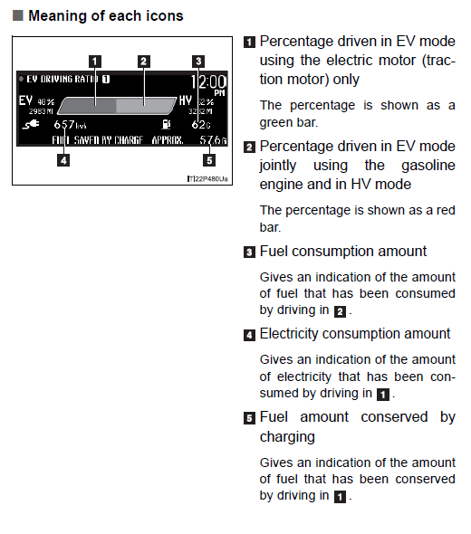

    Is that true? Can't be. When you're seeing trip, what happens if you quickly push the trip button (not press-and-hold) on steering wheel? It should cycle through all the options, one being mpg since last trip reset.
    Downloaded 2012 PIP Owner's Manual:
    https://techinfo.toyota.com/techInfoPortal/resources/jsp/siviewer/index.jsp?href=om-s/OM47818U/xhtml/OM47818U.html&locale=en&openSource=TechinfoPrelogin
    Here's an excerpt from page 272, note item 3:
    Hmm, maybe it is complicated..., maybe it's not giving total mpg, just mpg when not in EV mode?? o_O

    it has two trip meters like all ten 3, but the only way to get a real mpg reading is not to plug in. otherwise, it's just total miles divided by gas use. even though the car tracks ev and hv miles, it doesn't do a calculation based on hv only.

    Yeah I'm getting that now. Confusing that.

    took me about a year of ownership. a lot of newbies thought they were really getting 120 mpg.:p
    judging by the o/p's report of 72 mpg, i don't think he was using as much ev as he thought.

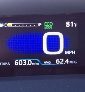

    2018 Prius Prime
    Well for one thing filling up less you think about getting gas less...
    I don't think there is any problem running the DTE to 0, just be sure to be getting gas when you reach that point. I will also point out that the DTE will go down much slower on a trip than if you stop and go. I have been 50 miles DTE, get in the car the next day, drive 20 miles and the DTE drop down to like 10 miles... At any rate, you have a small reserve, don't get too comfortable. Do realize it is a relative estimate. It might say 50 but you could maybe go 80 assuming you average over 100 MPG for the next 60 miles or so....could be 9 miles if you've got to climb a mountain.
    Common sense says look at the gauge, if you have 1/8 th tank showing (4th gen) on a trip, get gas, if you're in a city, probably can go a little bit.
  20. AKCoffee
    AKCoffee Junior Member
    Jan 14, 2016
    46
    23
    2014 Prius v wagon
    Lots of EV over the last few days so the MPG was trending up...more extended highway time visiting customers early in the tank.
