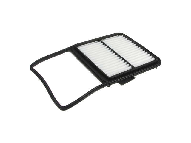

  16. yitsang
    yitsang New Member
    Apr 29, 2007
    16
    I just ordered a cabin filter and air filter.
    Just a question, is this engine air filter ?[​IMG]
    I ordered this already just want to make sure it is engine air filter.
    thanks
  17. Patrick Wong
    Patrick Wong DIY Enthusiast
    Mar 8, 2008
    18,210
    6,510
    Green Valley, AZ
    Yes, that photo is of the 2G Prius engine air filter. Notice the tab on the rubber gasket, which fits into an indentation in the air cleaner housing on the side facing the engine compartment firewall.
