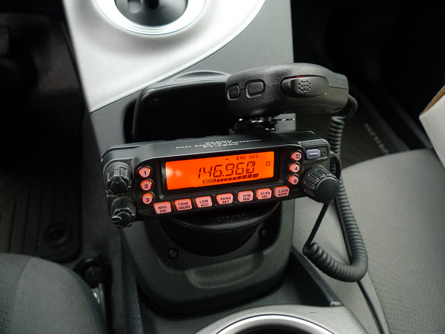

2012 Prius Three Yaesu FT-7800 dual-band 144/430 Mhz with remote kit. Trunk lip antenna mount on rear hatch, left side, 6 inches from top edge 19.7" Dual Band Stainless Steel Antenna Remote speaker (under driver's seat) Goal: no holes, easy to disconnect Wired straight to battery, with +/- wires both fused Mounted in the left-rear cubby- upholstered board velcro'd to plastic all wiring tucked and tied How to mount the remote head on the dash? Yaesu FT-7800 Remote Face Mount by schlem - Thingiverse MORE PHOTOS: 3D Printed Yeasu FT-7800 Remote Face Mount - a set on Flickr Antenna / wiring pictures pending. I am really happy with this install, and the mount. Probably the nicest mobile I have owned. Does anyone have any thoughts on getting the antenna cable into the car? Rather than drill a hole, I routed the cable around the rear hatch gasket above the bumper. I am thinking about finding some kind of rubber/silicone tape to bridge the wire, giving a solid seal against the hatch. Thanks for looking!
KE7AJZ : Looks like a nice install..i did more-less the same thing with the coax...at first i went above and around and in from the top of the hatch and went under the plastic covers above the door...but i found out that it wanted to leak around the top of the hatch...so we went to the bottom...into the car from the bottom along the hatch ...like you and it worked out much better...the 7800 is a n excellent rig...you shouldnt have any problem with rf floating around...with +/- going direct to +12v...i have a diamond ant on the hatch...73
