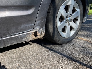

    IMG_2609.jpeg Has anybody seen for sale , pre formed , sheet metal body parts for repairing the rocker panel behind the rear door ? This seems to be a standard place where rust eats through on many of the early Prius gen 1 & 2 .
    Thanks

    Yes that should be available outter rocker panel replacement

    I’m hoping to find a corner piece that extends up the side a few inches. I’ve seen these repair corners for U.S. pickup trucks, but not for the Prius.

    Because you just call down south to a salvage yard for 1/4 rocker cut out. They send exactly what you talking about . I used to cut em out many yrs ago at Southside auto parts Durham NC
