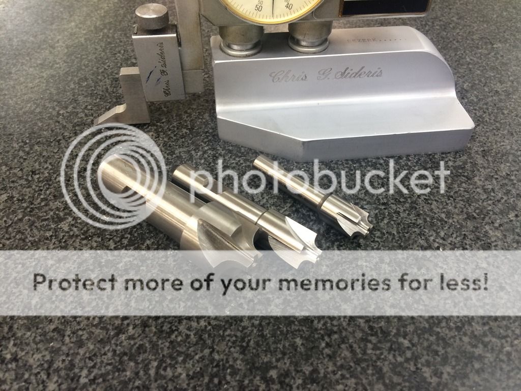

    To me, this is the best way to go.... (y) Tell your buddy, with the CNC, to just use a ball endmill to 3D profile your logo. Should be no problem with that machine. Or he could use a radius cutter like these...
    Also if these logos are for the outside of your car, you should have them powder coated instead of anodize. Anodize fad quickly in the sun.
