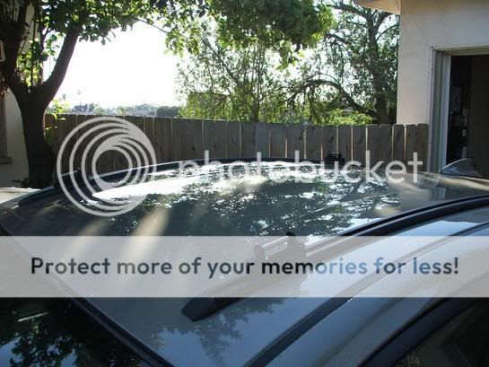

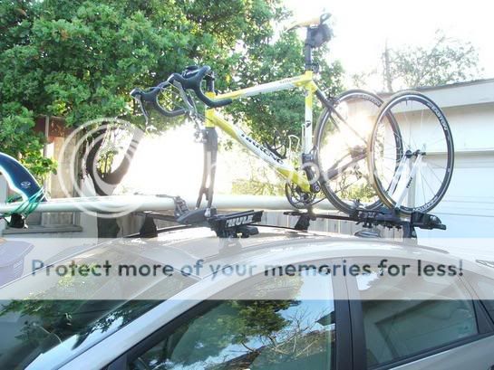

    I found a way to mount a roof rack that comes off by pushing 4 buttons so the MPG goes back up when not using it. It's a Thule system with TP54 tracks bolted to the roof (Yakima has identical system partially used by DarrelDD). It just depends on how seriously you want it to drill into your roof. I wouldn't have done it any other way.

    Just ignore your mileage when you need to carry some thing on the roof. At WORST you'll get twice the mileage of your Ford SUV. And the other 90%+ of the time you'll get WAY better mileage. It just isn't even a consideration for me. The worst I've ever done with a fully-loaded roof is the mid 30's. The rest of the time I'm above 50mpg.
    I highly recomment the permanent mount solution. But it isn't for everybody, certainly. Makes taking the cross-bars off just trivial, however. So there's no need to leave them on when you aren't using them.
    And there are plenty of options when you add a hitch. I use a combination of both the roof and the hitch.
    I agree with the fears of scraping my bikes off the roof! Scares the bajeezers out of me. I've seen the rack survive and the bike destroyed.
    jgills - If I had to do it over, I'd probably use tracks instead of just the landing pads. Live and learn. For sure I won't start off with clip-on racks for the next car (twice!) before doing it "right."
