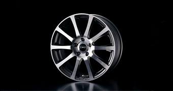

    TRD TF4 17" Alloy
    Pricey though...
    ¥139,125 for a set

    Oh I like that wheel!
