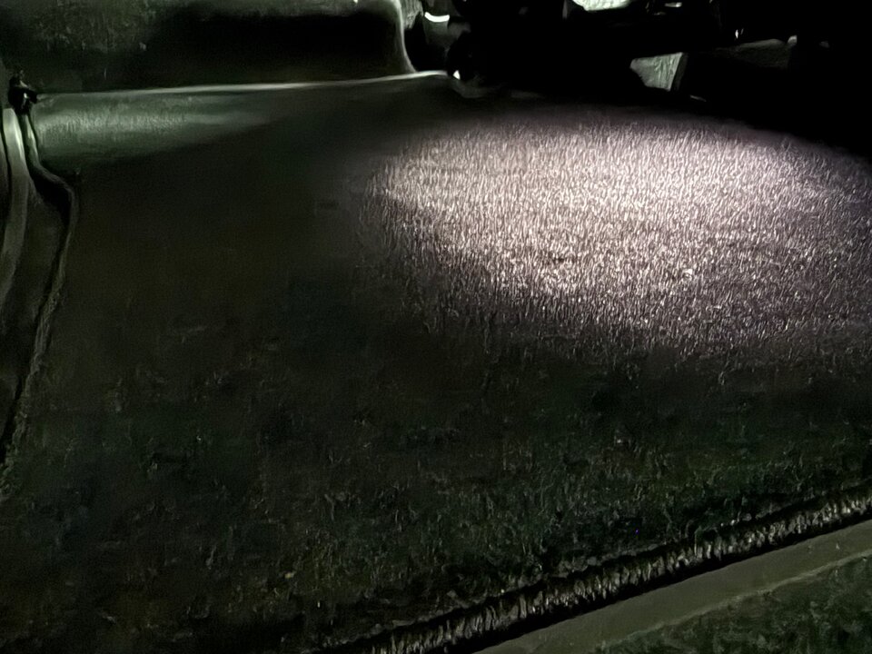

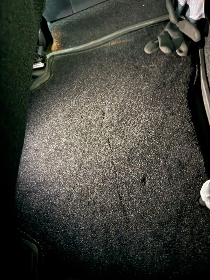

    I pulled all of the panels as instructed in the Japanese instructions. Was able to get the wire under the couple inches of carpet by using some of the wire I cut off the harness to pull it through. A lot of work for a little light but I like it.
    Here is a some pictures of the rear footwell lights.
