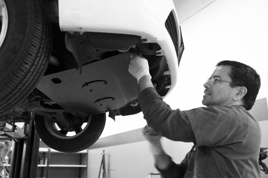

    Here's my lead tech changing oil for the first time(y). I put this 1/8" ABS plastic belly pan on our Prius five years ago and it has really kept the engine bay clean:

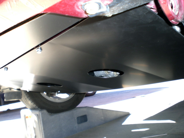

    Found this photo for the gen1 skid plate, and though they have a gen2 offering there is no photo in the product listing. There offering looks fairly robust, but also doesn't protect the bumper. Is it even possible to protect the bumper?
    Here is a link to their Gen3 skid plate for reference, linked here.
    Here is a photo of the old gen2 BT tech offering, notice the separate bumper strip :
    Access holes are covered this time
    and another bt tech skid install
