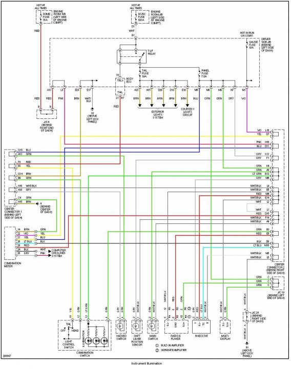

    Does this help.
    John (Britprius)

    It's very interesting, however it would be interesting to see what the various connectors hook too.
