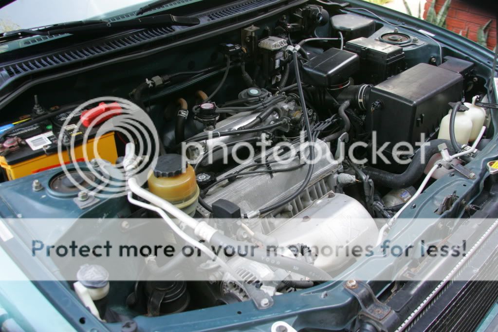

    Pic taken @ 13 years old RAV4 with a min. of 1-2 engine washes per year. Original belts and hoses replaced at 12 years/120k miles were still soft and pliable. Direct spraying of any electronics and intake systems is avoided as much as possible. Our Prius will get the same treatment (1 wash so far).
    If you stay ahead of the game, there's no need for harsh chemicals; just good ol' soap and water at the car wash.
