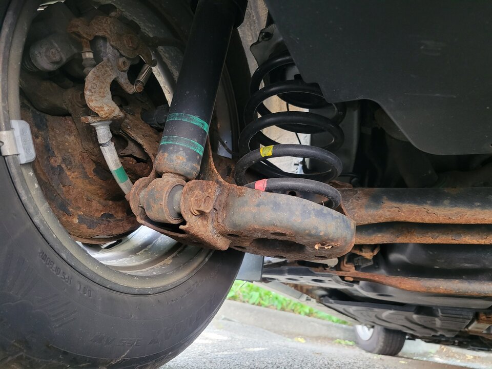

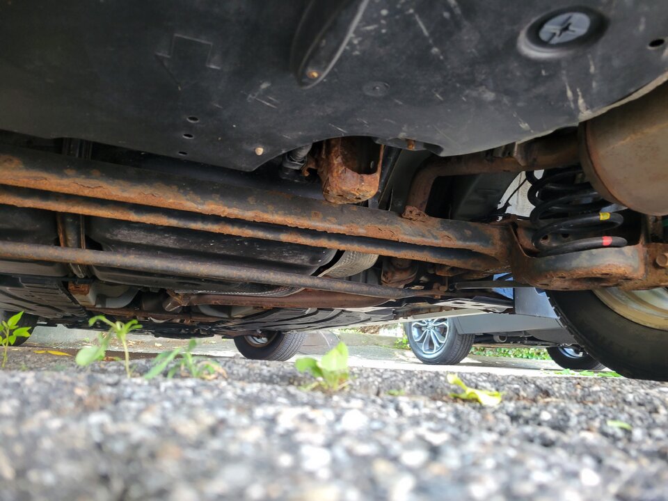

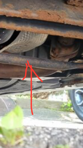

Thanks everyone for your thoughts! Just picked up the car. The quote provided was way lower than it sounded on the phone, $1400 for a used assembly (allegedly from the south) with the labor, so almost certainly will just get it repaired. Probably still will get a second opinion. Here's a photo if anyone feels like weighing in-- didn't have ramps or a lift so not great photos but figured I'd post them.
South Main Auto is a good channel and he does NY State inspections. He says most cars are rotted out in 10 years unless routinely undercoated with something like Fluid Film. In fact he sometimes won't put them on a lift fearing they might collapse. Another interesting channel in Rochester NY fixes up and sells older gen2 and some gen3 Prii. He buys them from southern states without rust concerns and makes a big deal of that fact. An example:
