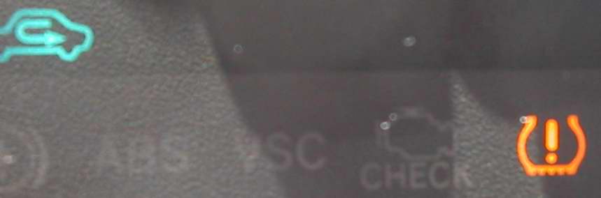

    My friend has a 2006 Prius and she started getting this symbol on her dashboard today. The symbol looks like this (!) It stays lit as long as the car is powered on. I'm trying to attach a picture of it.
    I don't find it in my 2005 Prius manual. Maybe it has changed since 2005 or maybe I not so good at navigating the manual.
    Thanks for any ideas.

    I have an '04 but to me it looks like a tire with the exclimation point.
    I'm guessing Low Tire Sensor. Take a pressure gauge and check them all.

    It's the tire pressure indicator. Check the tire pressure on each wheel; if they're within specs the reset button is under the steering wheel.

    Yep! Tire pressure was it. Now that I now that, the picture looks like a tire.

    That happened to me a month ago. I always thought I was pretty good at just looking at my tires and know if one tire was low on air. The low pressure indicator beat me to the punch. Turned out it was a nail producing a slow leak in one of the tires. So check the suspect tire for a nail or something that could cause a leak.
    After the tires are inflated to the pressures you desire, you will need to reset the indicator (see manual).
