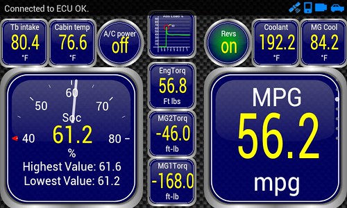

    Spend the money on Torque especially if you already have an Android phone (maybe it works on iPhone now too, not sure). So many temperatures to track you'll have trouble figuring out which are important and which are not.
    Here's my current dash:
    Current dash by bendertj, on Flickr

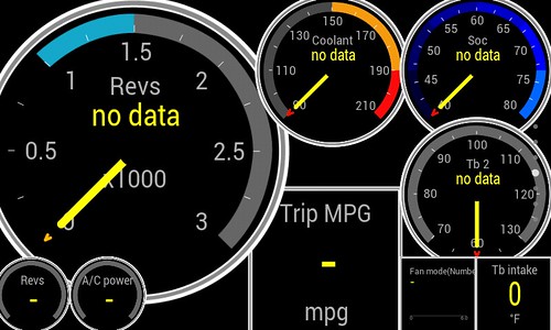

    Here's an older display:
    Torque app prius by bendertj, on Flickr
