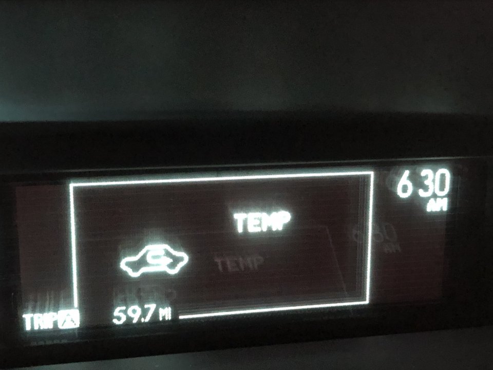

    When I try to change the settings (language, gas price, etc) in my instrument panel, I get a screen that says "TEMP" (see attached photo).
    2013 Prius Two

    i think it's the screen you get when you push the temp button on the steering wheel, give it a try

    Yes, I can make the "TEMP" screen appear by pushing said button on the steering wheel. But the image appears when I try to modify data such as the date, language, etc.

    are you changing the data from the steering wheel switches?

    correct

    maybe a bad clock spring, do the buttons and horn all work normally, in every steering wheel position?
