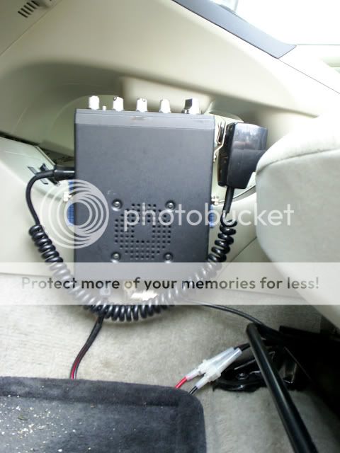

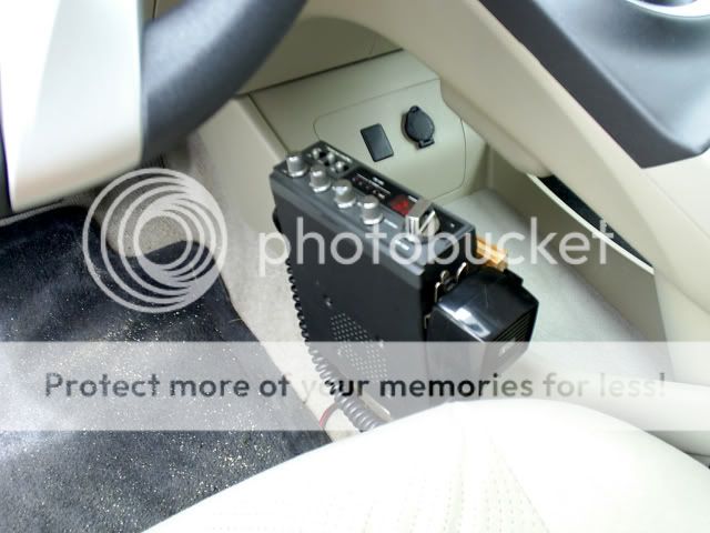

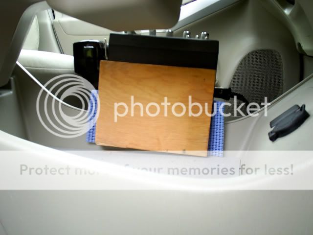

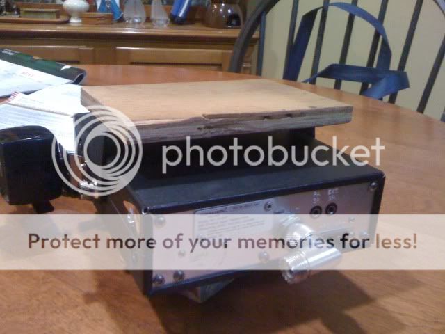

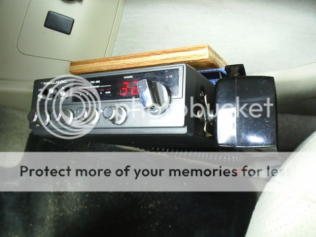

    I wanted to figure out how to temporarily install a small AM/SSB rig in my commuter car, 2010 Prius. Pictures speak many more words:
    Power is from the arm rest storage cubby, an in line filter with a standard Cobra/Uniden 3 prong cord, and just using a mag mount Wilson 1000 antenna, the radio is a TRC 465 CB.
    There's noise from the hybrid engine when you brake, but tolerable, otherwise, it's pretty quiet. No major hiss or white noise from the hybrid system.
    I'm happy with it.
    Greg

    Nice write up and creative mount. Do you notice any heat from the rig on your leg?
  3. MainerPrius
    MainerPrius Junior Member
    Apr 20, 2011
    SW Maine Coast
    Thanks! No, none really, my leg doesn't touch the radio much, if at all.
    It's only a 4 watt am/12watt ssb radio so it's not working too hard. One thing I'll be changing, is running power directly off the battery. Shutting down car also kills 12v aux port, aaaaarrgggg.
    Take care
    Greg
