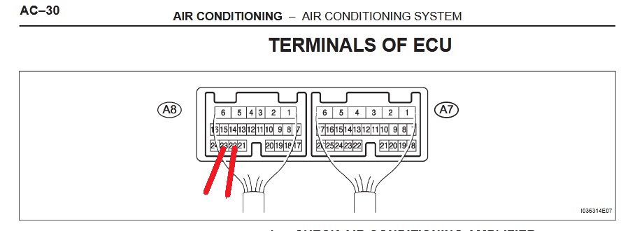

    https://attachments.priuschat.com/attachment-files/2018/05/146483_AC.pdf
    Page AC 30 for schematic
    A8-22 and A8-23
    12 volts to A8-23 P - W-B
    Neg to A8-22 G - W-B
    Sets it to Fresh
    Reverse that for Circulate.
    Set climate to one of the other, turn car off, then pull the A8 plug and use a battery to move it back and forth a lot to SWIPE the wiper and see if it cleans / clears it
    When done, make sure to SET it back to what you set on the car climate control
    The car is OFF while you do all of this.
