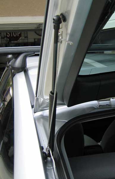

    piece of string near the gas struts to stop ot fully opening

    The next post will show how to do it B)

    Something like this?
    Read about it here.
