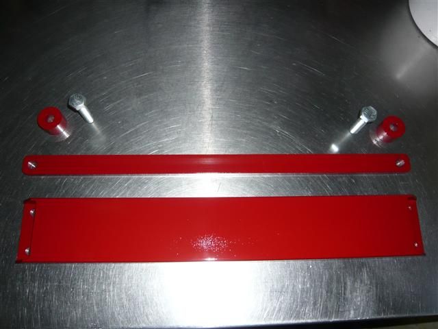

    For those who are interested, while I found the Tanabe a great improvement over not having a brace to "tie in" this section of the inverted "U" exhaust tunnel, I found that it could be improved upon, without the extreme pursuit of "lightening" by sacrificing the long term longevity of the bar.
    To my surprise, I developed a more "solid," stronger, and stiffer bar with just a slight 3 ounce weight penalty over the weight of the Tanabe. The Tanabe weighs 1lb2oz. Mine weighs a little under 1lb 6oz.
    The Tabnabe is made from tubing with a wall thickness of 1/16 inch, most likely 6061 T6 aluminum. The T6 heat and age temper, however, is weakened in that it hase been "melted" and allowed to cool in the anealed state, after welding.
    I stated the same 6061-T651 that Tanabe probably uses, since that is the strongest structual aluminum that can be welded. Mine, however, uses it in at least 1/4 inch (later 3/8 plus) thickness rather than the 1/16 that Tanabe uses.
    The Tanabe is mounted to the chassis with the original cap screws with washers that have an outer diameter of 1 inch approximate. This one inch diameter mounting circle marked by the bottom outer corner of the washer creates a "knife edge like" stress point that "digs" into the 1/16 inch thick aluminum each time that the bar is flexed.

    The Tanabe is designed as a welded unit based on one factor. Welding the light and thin aluminum causes distortion as the assembly cools. That's the reason for the large loose fitting mounting holes. Loose fitting mounting holes mean that the bar remains in position only because of the tension on the bolts and the friction between their heads, the bolts and the chasssis.
    In designing mine, the distance between the chassis rail bolt holes is precisely measured with special "pointed center" transfer screws and the distance between their centers precisely measured with a two foot long vernier caliper.
    All of the holes are so precise and "reamed" that they are only 2-3 thousandths of an ince larger than the diameter of the bolt. The holes are so precisely close that overspray from painting had to be reamed out for the bolts to be inserted.
    I have includes pictures that compare the mounting holes of the Tanabe to my design. Other design factors were considered but will not be discussed, here, since this post is long enough, already.

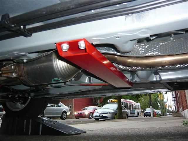

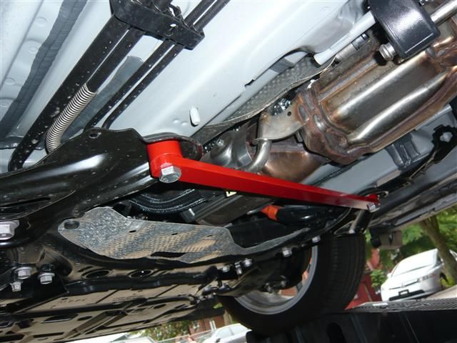

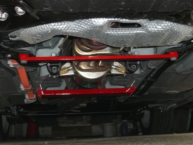

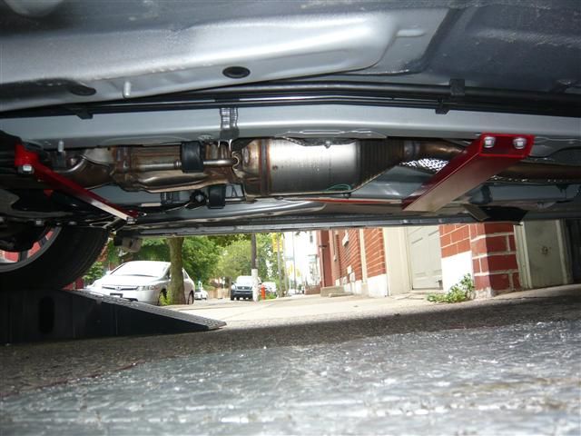

    I received a set from Mike and decided to paint them red. I used the brake caliper paint which I hope will help minimize the corrosion from salt spray in winter time.
    The first thing I noticed was that how snug fit the bolts to the holes as well as the spacers. I put my V on the ramps and finished in about 25 minutes. All went very well and there's no misalignment of the holes at all. I started off all the bolts by my fingers and alternate criss cross just like when I tighten the lugs when I rotated the tires.
    Everything fit like "custom" gloves...:D

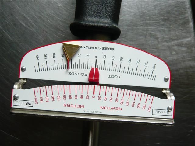

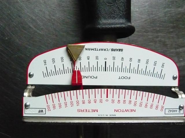

    BTW, I found out that the torques wrench scale is somewhat difficult to read especially when you work at the weird angle. I put a small magnet with red arrow paper glue to the magnet as seen in the picture below. First I use my thumb to bend the needle until it touch the arrow at the torque number I want, then set the magnet there. This works great. :D

  18. Mike500
    Mike500 Senior Member
    Mar 1, 2012
    2,593
    766
    Super NICE!
    Your install looks better than mine. I'm glad that it went so well.

  19. Mac Prius
    Mac Prius Mod Junkie
    Feb 2, 2012
    213
    San Diego
    Nice job tanasit! So how does it ride with both braces on? I have the Tanabe front brace installed so I would be interested to hear how much the mid-chasis brace affects the ride.
    Awesome job to you too as well Irv.

    Great idea for the torque wrench, I've always thought that they should come with that kind of device standard to indicate that you've reached your torque settings.
