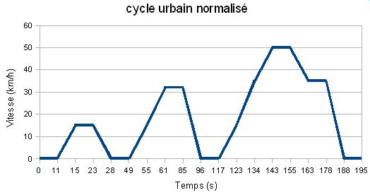

    Urban cycle's top speed is 50 km/h.

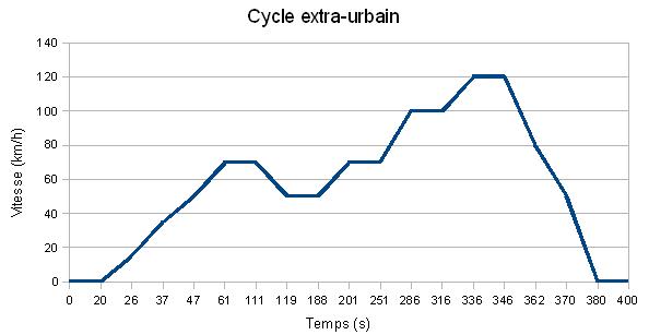

    Extra Urban cycle:
