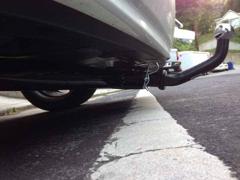

    In regards to trimming panel and ground clearance;
    From what I recall during during install, the lower panel seals off area behind bumper... the ECO hitch is hidden in this area, so for hitch receiver to be exposed, you would have to trim.
    About ground clearance, the lowest and further point is what risks scrapes, which is the receiver portion and not the cross member. So my take is the ECO hitch has no advantage there as receiver is in the same location. I'm keen to this as my car is lowered and I have a steep driveway. The cross member isn't the issue at all. I have a photos somewhere.

    Here's a clear photo of clearance..

    btw, that photo is before I lowered it.

    If the bumper is the reference point, it can only be higher by 1" max. From what I saw in the video, the ECO hitch is acutually wedegd against the bumper so perhaps 1".
    If you're referring to clearance in that photo, that was to show even in a steep driveway, it clears. This is prior to Plus springs.
