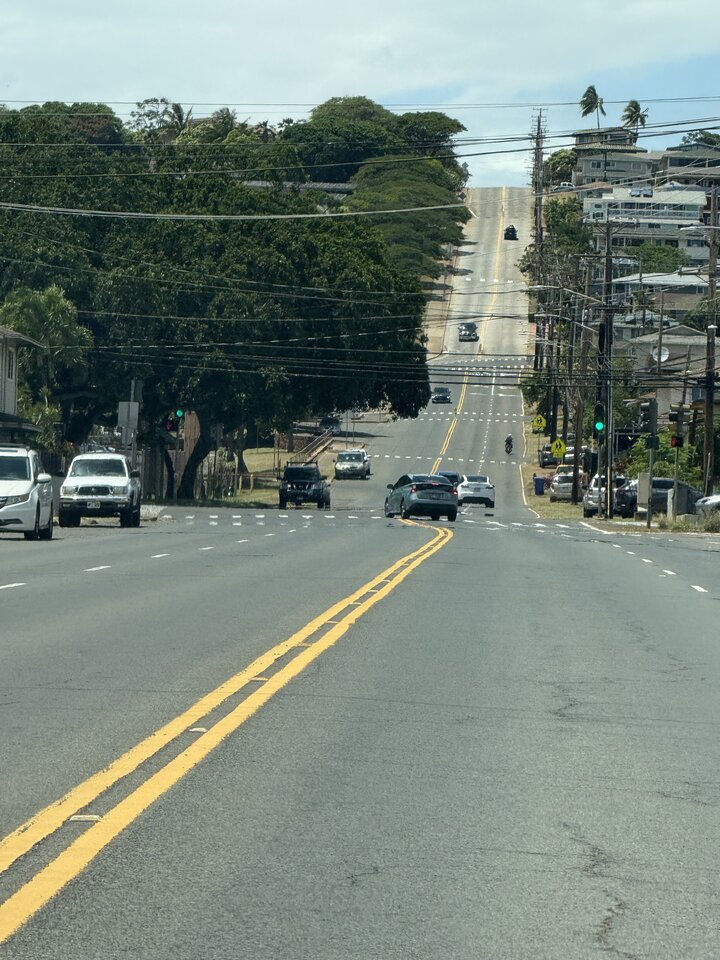

    I have noticed on occasion after going down a long steep hill that our 2017 Prius has issue with its transmission changing gears as we accelerate again. It revs up and then may finally bump into gear. Turning it off and then back on helps clear it.
    At our last servicing our dealer told us the after market battery in the car was failing their test. subsequently we had daily episodes of gear switching issues after descending a steep hill near work and read that a failing 12V could cause problems with the transmission. We replaced the battery. Things seemed to work fine for a week or two and then we noticed the issues again, always after going down the steep hill. I recently decided to put the car in neutral going downhill. Three days in a row and magically we have not had any trouble after descending the hill when using neutral. I suppose it would be better if we used B mode on the stick, but it is surprising that we have this issue particularly after going down long hills. It seems the transmission gets glitchy from the stress of the hill if left in gear going downhill. Anyone else have these issues?

    How long of a steep hill? Post a google map route, end-to-end?
    for the steepness: have you tried shifting to B, and is braking still needed?

    I'm so sorry for the late reply. I wanted to post a video of the descent as well as a picture from the bottom looking up. I have been using B mode on the stick and it is just fine.
    I tried to post with video and image link but am being denied because I am a newbie to the forum. I have uploaded the image, but can't upload the video of the drop. The drop is about between 37 and 45 degrees. Pretty steep.
    I am not sure how to check the traction battery cooling system. But shifting down into B is helping the situation most definitely!

    The degrees are greatly exaggerated.
    The steepest section, from the "Downhill" sign to 18th Avenue, is 1,050 feet long, the difference in height between the top point and 18th Avenue is 120 feet.
    The slope of the slope is α=6.7° or 11.905%

    On a lark I asked my wife what she would estimate the slope of the hill being and she guessed 30 to 35 degrees. When I told her it was a 6.7 degree slope she had a laugh. I jumped on Google Maps and Google Earth and used the elevation and distance and calculated it and it just doesn't seem to comport with reality. Kilauea drops and then flattens out at each intersecting avenue. I did the math and there are sections where the angle is 10 degrees by Google's numbers, but I swear it doesn't feel that small. But I am open to the idea that my perception of angle is off...
    Regardless, today I forgot to shift into B and by the time I reached the school after the intersection at the bottom, my engine was revving high. I turned off the engine for a few seconds, but later in traffic I found the transmission sluggish to change gear on flat road. Shut it off again and it returned to normal. But it seems by downshifting to B mode and applying brakes until the school I can avoid all of the issues. So I will continue this method, but am curious as to the underlying cause.

    I did not find any sections with more than 7 degrees.
    At each section 15-16, 16-17, 17-18 the elevation drops 36-46 feet, the distance between the intersections of the road with the streets is 340-360 feet.
    From 18th Avenue the section becomes more gentle and at 22nd it is almost flat.
    Measurements "by eye" and practical measurements are quite different things.
