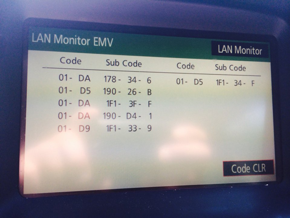

    Hey guys I need your help on this one as I have not come across this problem with any of the Prius. I currently have a 2008 Touring Package 6 with 180k and I am getting weird problems. I am getting the triangle of death, VSC, and yellow ! light. There is no check engine light. On the LCD I am getting the red battery + - icon as well as the car hybrid icon. I scanned it and I am getting a hybrid code P0A09 . All of the maintenance have been kept up and all fluids are perfect. No weird noises and the car is doing 53 mpg. It switches between gas and electric with no problems at all. Symptoms were yesterday with the lights. I cleared the codes and they would come back instantly. Today, I did the same thing and now everything is perfect. I am attaching the pictures of my dashboard lights that were on and the codes I was able to obtain in diagnostic mode.

    That is pointing to Hybrid battery failure usually evidenced by hearing the Hybrid Battery cooling fan run in the back seat and the charge cycle on the MFD of the Hybrid battery showing quick changes from full to depleted.
    The Lan codes you pictured are rubbish and only have to do with the manufacture of the MFD Touchscreen itself they have no diagnostic property.

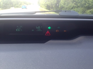

    Still having this problem. Triangle, VSC light and brake light. On the screen there is a message,
    "There is a problem with the transmission "P" lock mechanism. Park your car on a flat surface, and fully apply the parking brake."
    We live in Dallas, this problem seems to happen randomly, but almost always after or while driving at high speeds in hot weather. most times you cannot turn the car off right away. We have to press the power button repeatedly.
    We usually wait a while and the lights go out, except for the red triangle. If the red triangle stays illuminated, it's never on the next day after resting overnight.
    We have taken this car to two different Toyota dealers and both have told us that there are no codes, so they don't know what to do. I did replace the 12v battery on the recommendation of the dealer. That didn't seem to make any difference.
    Thanks to anyone that can help.
    Dan

    That error message is the most classic sign of low 12V battery voltage. You need to check the actual voltage of the battery. Give it a complete charge with a battery charger. Make sure the bolt to the car body from the negative lead is fully tight. Check the voltage both at the battery itself and at the jump terminal under the hood, and with the car off and in ready mode. You should see ~14V in ready mode.
