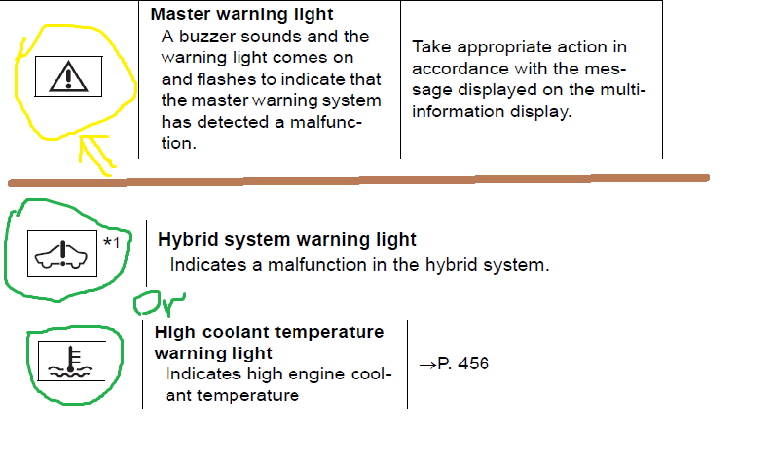

    I Attached a pic of the sign that appears to me !
    i checked the manual but i don't know if the sign that appears in the screen is for the temp. or for the hypride !!!
    Please any farther information from an expert or any prius user !

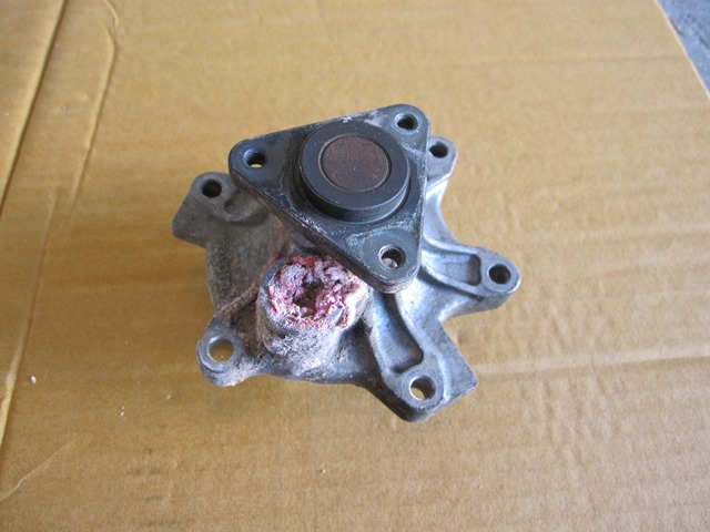

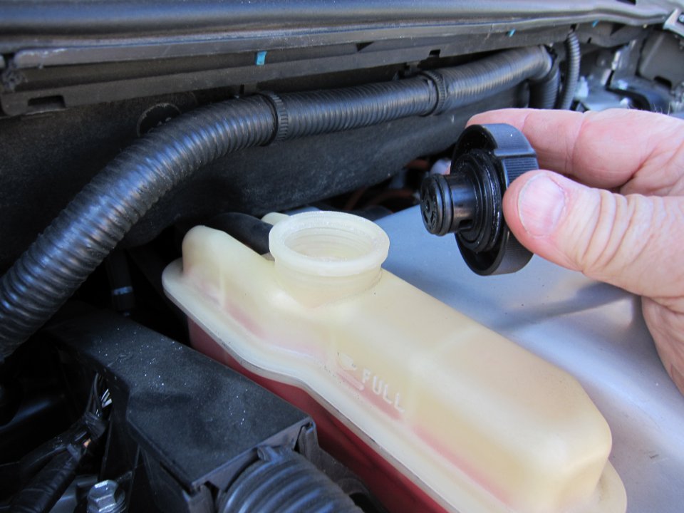

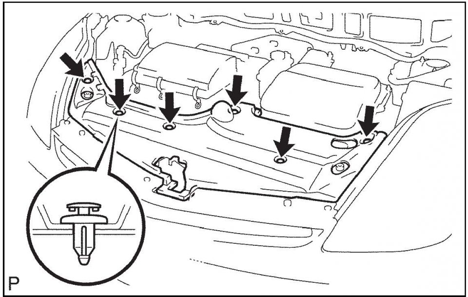

    First of all how many miles? If it's a cooling problem you need to check the coolant level in the radiator when it's cool. Have to remove the radiator support opening cover over the radiator to get to the radiator cap (Picture attached). Only remove radiator cap when engine is cool. Engine coolant reservoir (in front).
    Second Check the inverter coolant reservoir (IMG_1710 near the back) with the cap off and the ignition on. There should be good flow in the reservoir. If not, the inverter water pump may be bad. There is a T-SB recall on that (free replacement).
    If coolant in either reservoir is low, are low add Toyota Super Long-Life Coolant.
    Also check to make sure the v-belt hasn't broken.
    Check to see if there is any buildup of "pink crust" on the water pump, indicating leaking. (picture attached). If so, the coolant level in your radiator is probably low too and engine water pump needs to be replaced.
