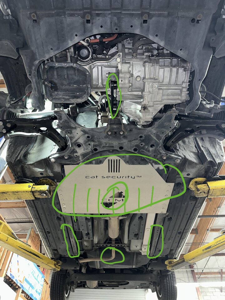

    I DID take it to a mechanic, who put it up on a lift, and he showed me where all the scratch/stuff marks were (new and old). It did scratch up the bottom in multiple places including the cat shield, and places i don't know the names of, but he said there shouldn't be any serious damage. No charge.

    Last update before bed. I think i found out what happened. There was a large scrape on the engine mount thing, which the guy said was the lowest point of the car. I think it got hung up on there, did some damage. Here's what I found so far.. along with a 2000-3000 dollar repair cost.. please let me know what you guys think

    This is a picture I found online, these were the notable "new" scratches, both shallow and fairly deep IMO.
    - dog bone pretty deep scratch/part of it scraped off maybe 0.5mm-1mm ( just imagine it scraping on cement) will go check soon if it wiggles or is loose.
    - various locations on cat shield, partly pushed inwards, especially around the cutout words.
    - the 2 bars on the left and right, idk what they're called but as a non car things knowing guy, it looks like part of the frame. Had maybe 1-2mm deep scratches.
    - back end that dips lower than the rest, of that exhaust pipe also got banged (not deep or badly from what I can tell) but MIGHT it have been knocked and pushed out of position? So it didnt suffer surface damage or scratches, but dislodge or bent somehwere?
