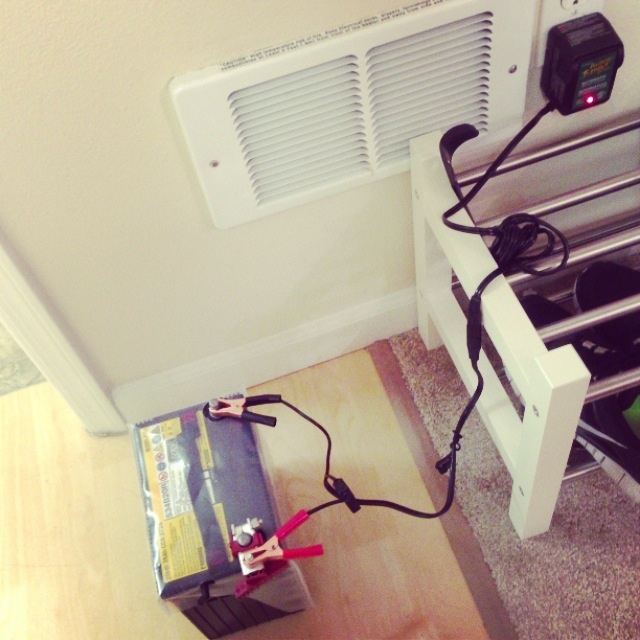

    Here's an update. About to leave for vacation soon and got everything out easily. A few 10mm nuts and a 12mm took care of the battery.

    Realize your close to leaving but they make solar trickle chargers that sit on your dash inside the car for extended vacations that plug into your lighter socket. Try Amazon.

    Be alert to the fact that the cigarette lighter are dead when the Prius is off, so you will need one that clamps to the battery not the lighter ones.

    A newer battery with a decent charge will be fine sitting for 2 months while you're gone. It's also summer time with warm temps. Just lock it up and call it good.
