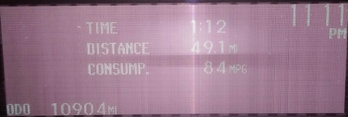

    This was from the trip back home with a full charge at in-law.
    It was an hour and 12 mins drive covering 49.1 miles. We used heater when ICE was used.
    0.585 gallons burned at the rate of about an ounce per min.
    Weather is getting cold. Air in tire was 37 psi front / 35 back (for comfort) before the temp dropped.
    I love this car!
