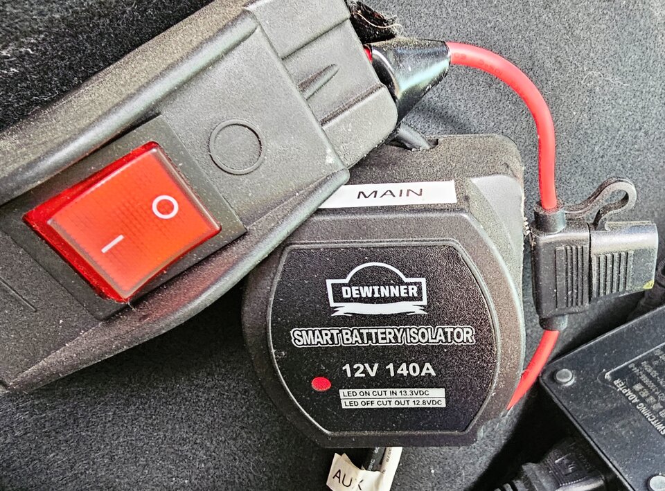

    I may have something...

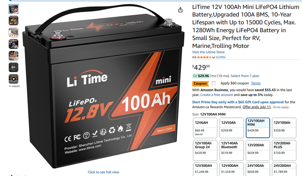

    I was looking at isolators on Amazon, and some of them say, "not suitable for lithiun batteries, which is my auxiliary battery. The isolator I currently have makes no mention of suitability for lithium so I ordered a different one that does say it's compatible. It may have something to do with incorrect triggering voltages.
    This one is adjustable, so that may be the answer.

    I've got the new smart isolator arriving here today. I only ordered it yesterday.

    As I mentioned many times, the Toyota 12-V battery-management system (BMS) is not compatible with an LFP (LiFePO₄) lithium-ion battery. It will not charge it properly. Those LFP batteries are intended for dumb charging systems without a BMS, like the old alternator/IC voltage regulator systems.

    I'm going to be able adjust cut-in and cut out voltages with this new isolator.

    Relax, it's been doing a good job for over a year now. I just need to tweak some switching voltages and it will be perfect.
    My problem is that the lithium battery is rated at 12.8 volts, which is the cut out voltage of the isolator. My system runs at about 12.4-12.6V most of the time for some reason, so that explains why my lithium auxiliary battery went dead on that long road trip. The drinks cooler was drawing 5 amps continuously. During the winter, I often saw voltages of 14.1 which is above the cut-in voltage of 13.3 of the isolator, which explains why it never went dead over the winter. I was also not running the cooler, so I never noticed a problem until the other day on my 15 hour road trip.
    I believe the charging regulator sets a higher charging voltage of 14.1 in colder temperatures, like in winter for better longevity and performance. This summer, I'm never seeing it go over 12.6, which is better for the lead-acid battery in warmer temperatures.
