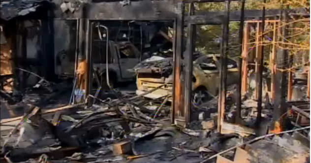

    Heard about this story on the radio yesterday and found this link. They don't think the Volt or the charging station was to blame, but I'm waiting to hear the official cause. It could be very damaging to plug-in sales. Let's hope not.

    from what i recall. the home made samuri EV or the wiring to the garage caused the fire, not the volt.

    Unofficially official: Volt cleared in Connecticut Fire
    Exclusive: Chevrolet Volt unofficially cleared in Connecticut garage fire
    GM-Volt
    Jeff Cobb
    May 18, 2011
    After flames of rhetoric alleging the Chevrolet Volt might have caused a Connecticut garage fire last month, the case has basically fizzled from the media’s attention, but yesterday the local fire marshal in charge said the Volt was cleared of suspicion in his mind.
    “It wasn’t the cars,” Barkhamsted Fire Marshal William Baldwin told GM-Volt.com regarding the cause of a fire at the Barkhamsted residence of Dee and Storm Connors.
    Officially the fire marshal’s report still states the cause was “inconclusive,” but as the local fire official responsible for the investigation – among other investigators – Baldwin’s view yesterday was at least conclusive about the big question surrounding the Volt.
    So, we asked, what was the cause? Could it have been the garage wiring or some other incendiary source?
    He said yes it could have been, but he does not believe it was the fault of the Chevrolet Volt or a home-converted Suzuki Samurai EV that was also in the garage at the time of the fire.
    According to Storm Connors, the owner of the house and the EVs in question, his garage had a number of flammable items laying around. This is what he wrote on his blog April 20:

    Why didn't GM respond to the Volt's battery rekindle issue? Maybe I missed it.

    Possible sources of combustion: lithium batteries and water? Just a wild guess on my behalf.

    Was it even nailed down to the battery? Missed hot spots in any fire can rekindle hours or even days later. It's why fire departments will flood a fire long after what a layman will consider out. But they are still human, and mistakes can happen.
