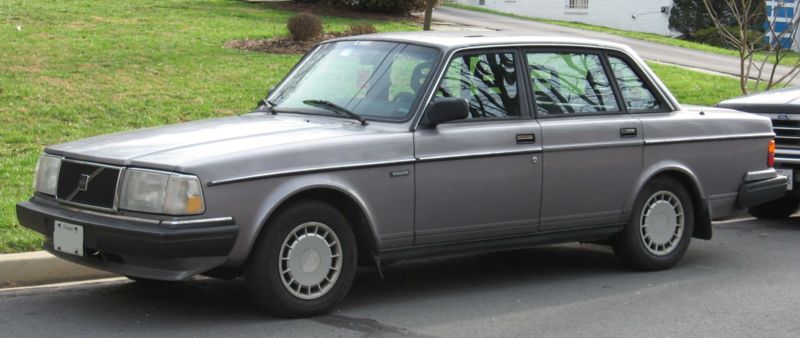

    hey guys my name is bud i recently acquired a 2004 prius that has been totaled. i have been a long time volvo person and i want better gas mileage so i want to know how to convert my volvo to prius drive. i have an entire prius so parts won't be a problem lol. btw its a volvo 240 1987 with 450k still running strong just want more mpgs!
    thanks in advance
    -bud
    this isn't mine exactly lol but it's close

    The Volvo is a front engined, rear wheel drive car with the engine front to back, while the Prius has front wheel drive, and and engine and inverter aimed side to side. So nothing will fit.

    This is similar to my convertible project, but the Volvo is not well suited to it. If the body width, wheelbase and tread width are compatible (which does not appear to be the case) the entire underbody would need to be cut out and replaced by the Prius parts. This would be a very complicated process in this case since the differences in seating location and firewall location may be too great to overcome. Bottom line: The Volvo is too small to make this work.
    I advise selling the Volvo. :)

    ok for one i already have a secondhand prius that runs its just been wrecked. and two i think volvo drivers are great lol so i don't know what you mean drive it badly. why do you think volvo insurance rates are so low lol its because they're great drivers.
    ok first off, thank you Volvos are beautiful.
    secondly this prius only weighs like 200 pounds less than the volvo and the volvo has narrower tires so no.
    prii have brake calipers just like every other car they just use an electrical load to supplement the brakes.
    yeah well people said prii were impossible too
    i like this idea but the prius interior isn't as nice as the volvo and my seats on have like 4 or 5 rips so its still in good shape lol. im very handy with sheetmetal i do bodywork
    my plan is to put prius cradle under front of volvo and put all prius electricals inside
    impossible and i'd rather sit in my volvo
