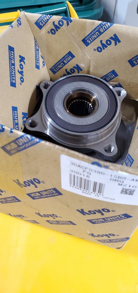

    I bought an "OEM Koyo" front Hub/Bearing on eBay.
    Had a gut sense to check carefully... and noticed a few things:
    • Packaging appears to be official Koyo
    • insulation inside seemed a bit haphazard
    • The actual hub is different in two ways
      • It has NO markings. The original has "Koyo" and a part number etched in the steel
      • It has a plastic ring between the bearing and the hub. The original doesn't
    Asked the seller about this. They made a few claims in return:
    • We buy direct from Koyo. This absolutely is the OEM part, the latest version
    • Any difference is because this one is newer. It will be the same if you purchase from a Toyota dealer.
    I called Koyo North America (JTEKT). They had a different take:
    • We never sell to third parties. We only sell to manufacturers
    • All Koyo hub/bearings DO have "Koyo" and the part number etched
    • You were likely sold a Chinese counterfeit
    • We recently changed our outer packaging. Most likely someone has sold a lot of the old boxes to counterfeiters.

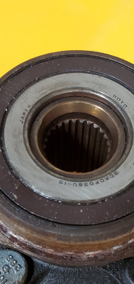

    I have now examined a number of photos on eBay of "Koyo OEM" hubs/bearings. MANY show no markings. (A real one has the name and P/N inside the ABS/Speed magnetic ring on one end. Quite visible.
    Real: 2023-02-16 17.04.21.jpg
    Fake: 2023-02-16 17.03.26.jpg
    I've reported the seller I purchased from. Buyer beware!

    I have no problem with non-OEM parts. In fact, that's what I ordered as a replacement.
    What makes this bad is they are claimed to be Koyo OEM... but are not!
    According to Koyo, there's NO legitimate 3rd party source for them.
    Here's an interesting web site for what appears to be an industry-wide issue: WBA Stop fake bearings
