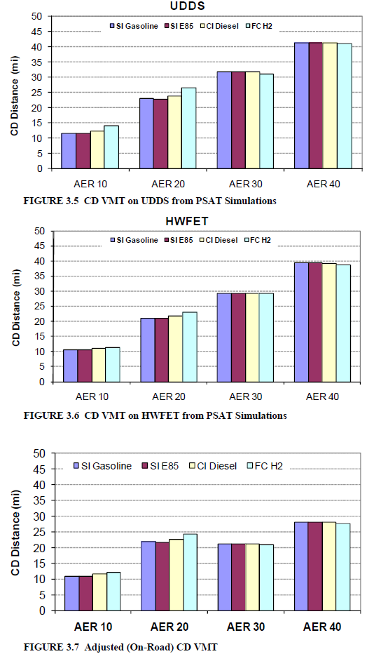

    Sample graph from the report:

    That's quite a report. Over my head at a glance.
    Figure 3.7 (p. 41) seems to give the -10 and -20 their AER, but cut the -30 to -20 levels and the -40 down to -30ish for on-road real world driving. Says that the power-split -10/-20 will use gas to overcome conditions, while the -30/-40 series designs will sacrifice AER to keep the ICE off until depleted. Do I understand that correctly? If so, how does that reconcile with the lack of choice on EV vs HV in the Prius PHV prototypes? As tested by our forum members, wouldn't AER be reduced more or less proportionally to that of the series design?

    Yea that's how I am reading it too. AER20 (power-split PHV) will have the same real-world EV range as AER30 (series PHV). AER20 will use gasoline to cover peak power demands and keep the all electric range consistent. AER40 gets about 27 miles in real-world.

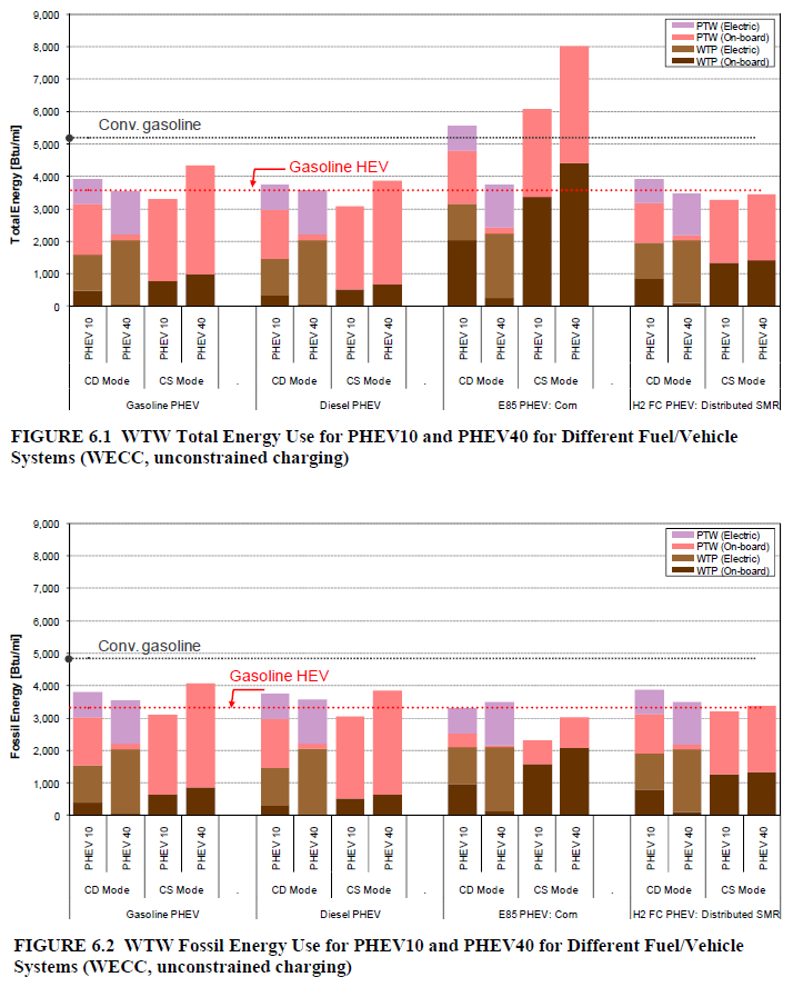

    AER40 series hybrid (like Volt) is not as hyped up to be. Volt-like PHV can displaces more petroleum than PHV Prius in the CD mode but the opposite is true in the CS mode. The green house gas emissions are higher overall. PHV Prius lowers GHG emission over a standard Prius. See below:

    If you look at the total energy usage (below), Volt-like PHV uses the same energy as a standard Prius in CD mode and more energy in CS mode. From Fossil Fuel point of view, Volt-like PHV will use more than a standard Prius in both CD and CS mode.
    The bottom line is that a standard power-split HEV (Prius) is hard to beat. It gives the best bang for the buck to reduce fossil fuel and green house gas without the need to plugin.
    Prius-like PHV outdoes the Prius by a little but the plugin premium is not known (announced) yet.
    Volt-like PHV on the other hand is a mixed bag. It cuts down the petroleum usage but not the fossil fuel usage. It also use more energy than a standard hybrid and emit more green house gas!
